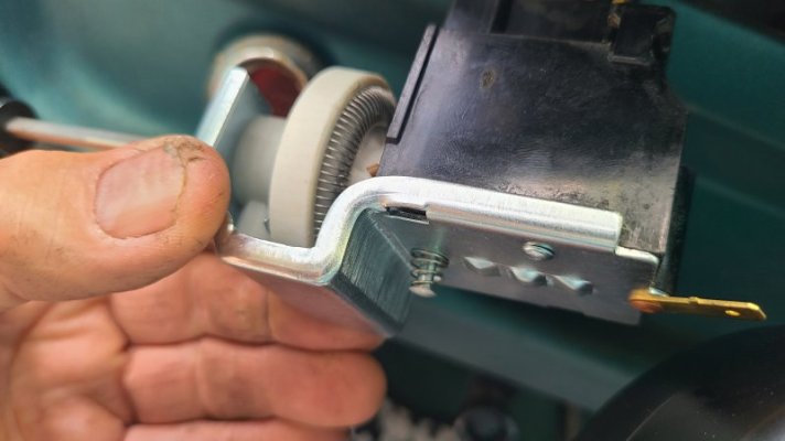

Well, I got a new headlight switch and installed it. Got the left side dash lights back, and the new switch has a ground tab on it. Maybe they figured out they have grounding issues? So, why did only half the lights come back?
