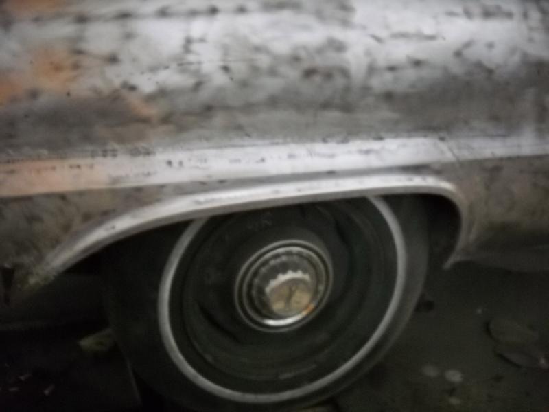

Here's a pic of a quarter patch from a 4D, used on a 2D.
You can clearly see the outline of the 4D "dog leg".
That's my brother in law's car, and I helped cut out the patch from the 4 door.
