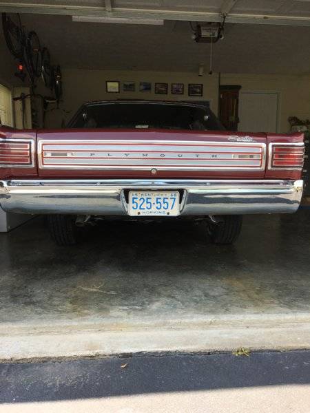

I want to refurbish the trunk panel on my '67 Belvedere. The aluminum is cloudy and it will not polish out. Am I correct in thinking that the cloudiness is under the anodizing? If so can anyone recommend a way to strip the anodizing?
