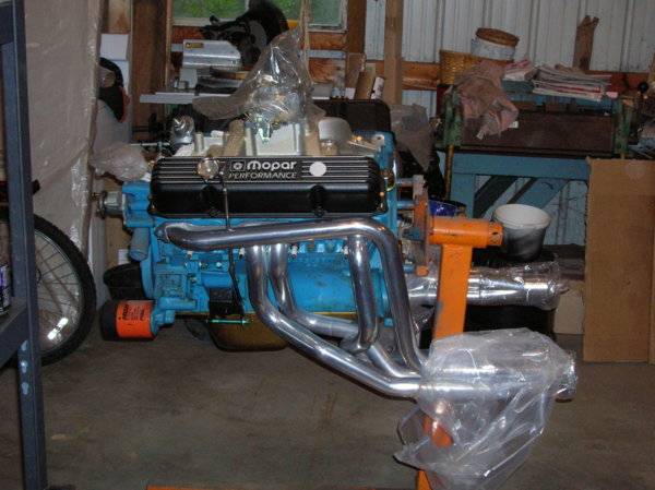

Did a 3" TTI on my 65 Dodge Coronet fit no problem. Mufflers That is where you need to look at carefully. I put Dronemaster 50 series they are noisy. Ins
tall from back of car and don't fully tighten until finished. I did an H-pipe and because I didn't use TTI headers had a little length of pipe to connect crossover pipe. I didn't want pipe clamps all over the place ( 2 on crossover pipe and 1 one each reducer so I tack welded all that together on the car. Removed h-pipe and welded the joints. The pipes will need trimming as you go but it wasn't hard.
