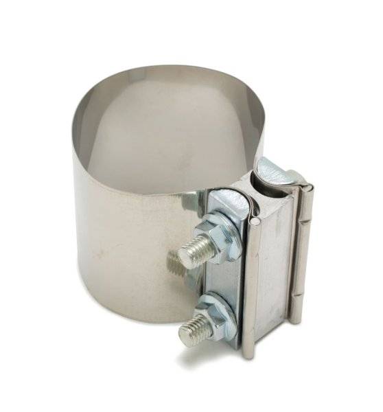

I used those on my 71 RR and they reached almost to the trans mount. Within 3 inches as best as I can remember. I just took loose the exhaust hanger and cut to fit and went to oriellys and bought 2 reducers then welded all together. You could use a flat style clamp to get it to a welder.
They are available from 2 in up to 6 in.
