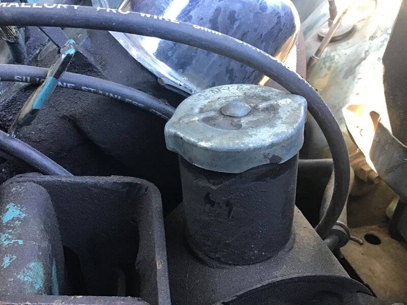

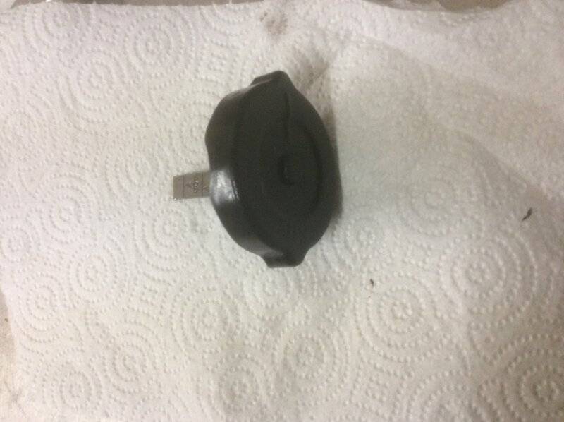

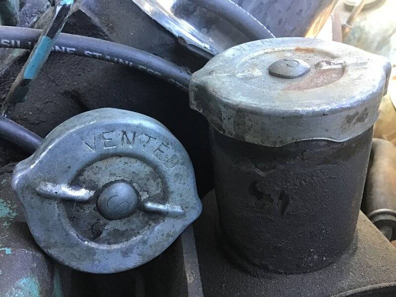

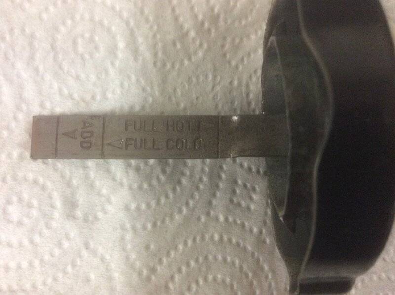

The one I lost had a dipwick.

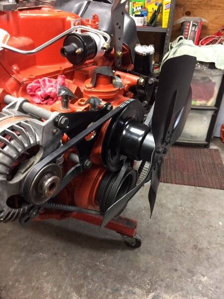

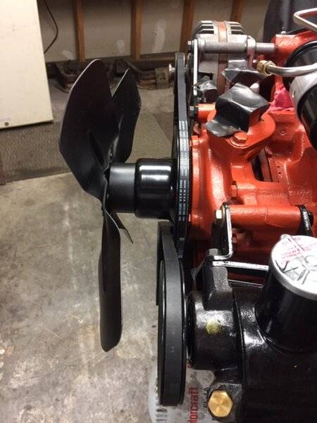

So they slowed it down a bit. For the higher engine RPM I guess.Hemi's get a standard W/P pulley but a smaller diameter & shorter height crank pulley
Wrong on all accounts LoL.I was under the impression Hemis got a smaller diameter w/p pulley. Like an a/c one. Not the standard BB one.

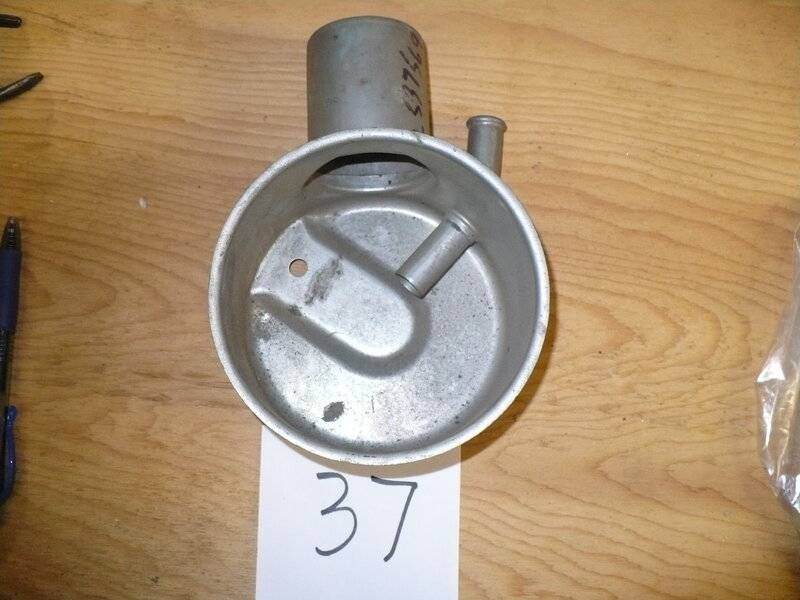

And p/s pump lids have dipsticks.

Some days it's better to just crack a beer & go back to bed....You are not totally wrong. 1969-1971 street hemi had different pulleys, the WP pulley was smaller and not as deep. You can fully see the 4 bolt heads to mount the water pump. They are not like an AC pulley, which were much smaller and shallower.I was under the impression Hemis got a smaller diameter w/p pulley. Like an a/c one. Not the standard BB one.
In 1966-1968 only.Hemi's get a standard W/P pulley but a smaller diameter & shorter height crank pulley
