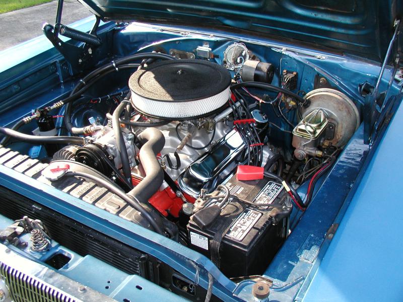

I retrofitted my '67 Coronet with factory air using the condenser kit and compressor brackets from BPE. It's been a year now with no troubles. Will cool down quick even without tinted windows here on the Gulf coast. Buddy 011.jpg
In traffic I get a 10 degree temp rise but if you're moving at any speed my 318 stays at 160. The kit is easy to install but you will have to get the hoses crimped once they are all cut to size and indexed. Yes, the parts are all Chinese made but I haven't had a problem. You will loose about 20# using the Sanden compressor over the stock one.
