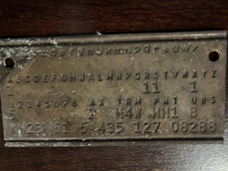

Good afternoon, I’m new to the forum and looking for some direction on where I can find a good fender tag decoder?

For a couple of reasons, most online decoders suck.
Follow Chi Town's advice and post it here. You'll, probably, get a more accurate decode and quicker turn around here than any place else.

Welcome from Alabama, your tag is a little hard to read, but I think I could come up with possibly a Coronet 383 2bbl, automatic, open rearend, and AM radio. It's 67 I think by the tag layout. Notable option A1 26" radiator. Others will know more.
Hey everyone. I reverse images my fender tag for clarity. Please let me know what you can decipher.
