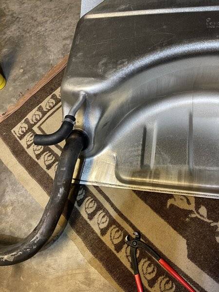

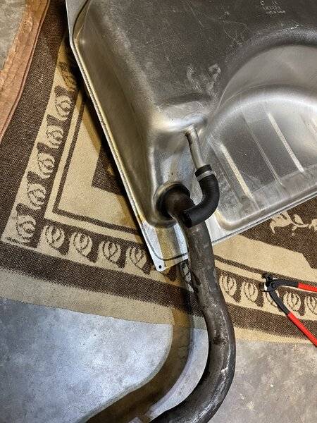

So, even warming it up and using both hands at a perfect angle took all of my strength to get the bastard in there….after dropping the tank. Geese
4DD0A728-6804-4F70-8E02-A6509050400E.jpeg 05C04864-3208-4BA8-AA5B-5B2EE1686647.jpeg
.....just a side note.....make sure you crimp the vapor line on the tank side prior to installation. You can feed the smaller vent line into the elbow after you install it.....but there is zero space to crimp later.
