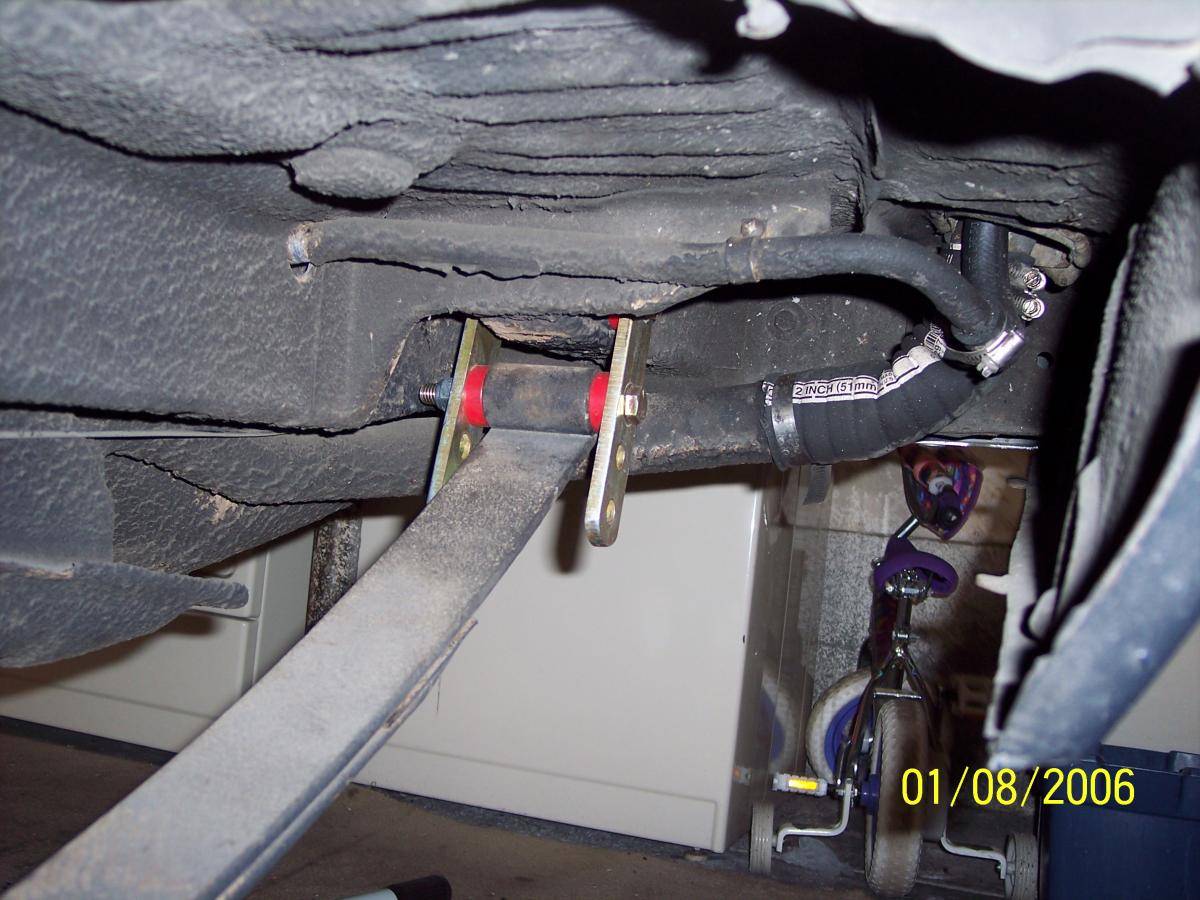

When I repalaced all the bushings under my Coronet I got new poly adjustable rear shackles. It has 3 adjustment, the top choice drops it 1 inch, the middle is factory setting and the bottom raises it 1 1/2".
