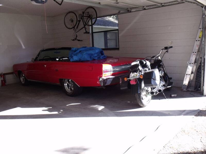

Folks , I have a coronet rt with dana rear . Running a set of magnum 500s with 225 70 15s.
The drivers side has more lip to side wall clearance than the passenger side , about an inch at least I’d say. I am getting a little rub when cornering to the right , other wise it’s fine. Anyone have these off set clearance issues and why do you think that is ?? Original quarters , car is straight as an arrow. Is this normal for the rear to be off set a little ??? I’m not sure the width of the rims , most probably 7 inch .
any feedback would be appreciated.
