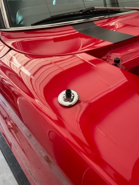

When i bought this car it was missing the antenna.I can't tell if it is broke off or you can just pull it out.
I don't want to buy the whole assembly if i don't have too.I can't see any threads so i'm not sure how it attaches to the base.
Anybody familiar with this? Thanks. Mike

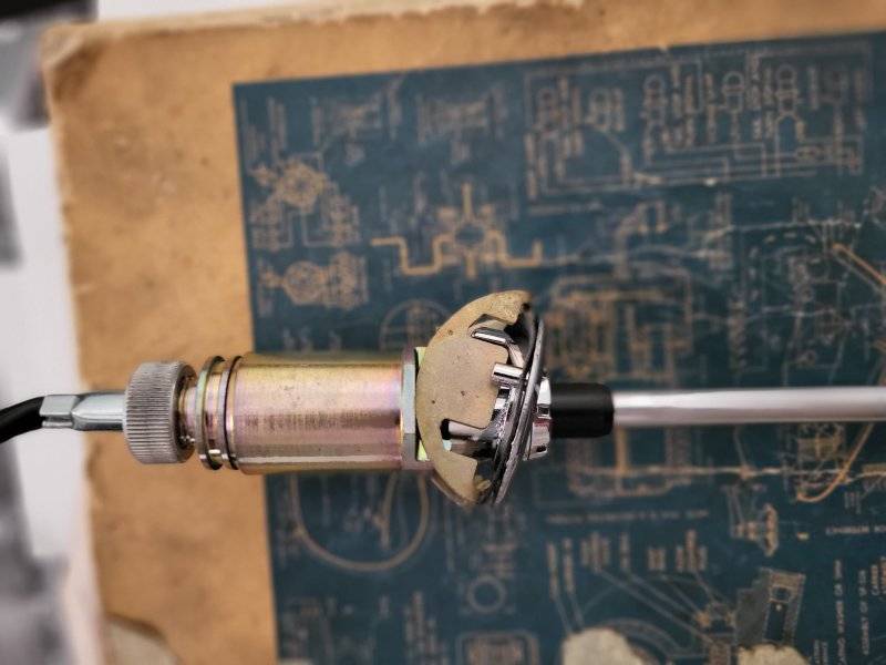

Looks like the mast was broken off. Should look like this...

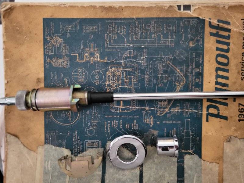

Another view with the nut, bezel and mounting bracket removed for clarity.
Not sure if you can replace just the mast, but most likely you need a new antenna assembly. Saw one posted for sale recently so maybe check out the parts for sale forum.

ok,thanks for the reply
