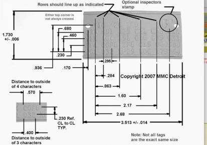

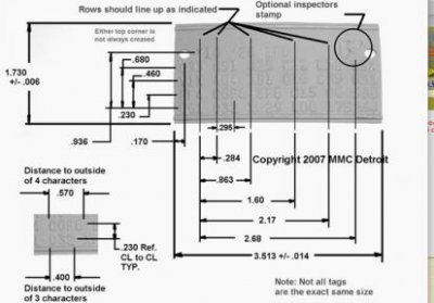

If anyone wants to take a micrometer to my reproduction fender tag to determine if it is a fake they are welcome to do so. or they could just ask and I will tell them it is a Backeast Reproduction. LOL The only thing I see after comparing my reproduction to some real ones more closely is that some of the numbers under my alphabetical letters line up perfectly. My 1's are offset to the left of the alphabetical letter same as on the originals, but not as far left offset as on the originals. My numbers other than 1 are dead center of of the alphabetical letter, where on the originals, they are offset slightly to the left also.
