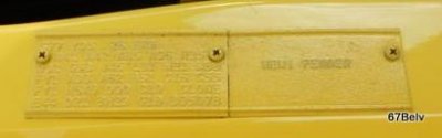

67 gtx
My understanding is that the RS23 indicates GTX where as a Belvedere would be an RL or RH. What am I missing here? Thanks
Whoever added the Belvedere fender tag to my GTX apparently diodn't know that! LOL
Whoever added the Belvedere fender tag to my GTX apparently didn't know that! LOL They must have just thought it needed a fender tag, and any fender tag would do. I am not the same car as started the thread.
Roger that. I got my wires crossed. I guess we are all on pins and needles waiting for the explanation on this one. There must be some reason the answers are not forthcoming.

Why is the plate off the car, and why is it not blue? I'd start looking for the stamped numbers on the core support and under the trunk weatherstripping. I hope this isn't a jigsaw puzzle car.
Here are the abc options
abc OPTIONS:
a6: Console
b5: Rear Arm Rest w/ Ashtray
d6: Unknown Option
j4: Moulding - Boldy Sill Narrow
u1: Sold Car When Built (Somebody Ordered It)
Are you getting something different than mine?
Why would it be blue? For 1967 QQ1 is dark red metallic. Body numbers on a 67 are on the radiator support and behind the rear bumper (if they are there); not on the trunk

So is anyone willing to say how they can tell that tag is a replacement tag?
The car has the rear speaker option just like the fender tag says Iwish I knew how to tell if it was a fake fender tag.Again I posted the tagjust like I was asked to. I have reason to believe the tag came on the car I took it off to take pictures when the car was restored back in 98 the tag was removed and sand blasted.Again any help would be greatly appreciated.Maybe it is the wrong tag I just know what It says code 48 for sure grip and code 3 for 4 speed it says itg plain as day again not saying I have a special carI think some one ordered yhe car with a 4 speed and a 323 rear for highway use why in the heck would any one order the car this way is beyond me BUT THE TAG SPEAKS FOR ITS SELF SOMEONE PLEASE PROVE THE TAG WRONG THANKS
Again, did you receive my PM listing the problems with the tag? If yes, then you have been told why it is a bad tag, if no, I will resend it.
Yes, the tag came with the car but that does not prove it is an original or correct tag.
please tell me again I didnt understand please spell it out you are not going to hurt my feelings if its fake its fake please tell us why you think its fake the facts are the facts either way its all good thanks for your help 69 rt coronet
The previous owner had the car restored it took several years the fender tag was removed and sandblasted and put back on the car unpainted when the car was finished it has sat in a garage since 1998
please tell us why you know it is a replacement tag

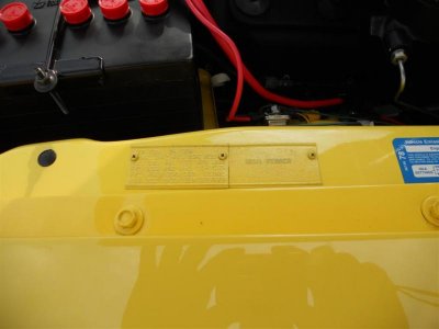

Note "CLONE" stamped into tag
