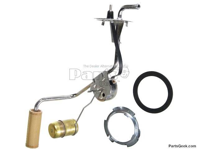

Does a 67 Plymouth Belvedere II have a fuel filter in the gas tank as well as before the carb?
Has a sock on the fuel sender. Could be plastic or it could be a mesh type. Other than that the only filter I know of is by the fuel pump up front.
Sort of like this.
Sort of like this.
Thanks. That wouldn't affect the amount of fuel that gets to the engine would it? Somebody was saying that might be why I'm not getting enough fuel.
The down and dirty way is to put air pressure to the fuel line and blow the sock off. Then you could put a filter in before the pump.
