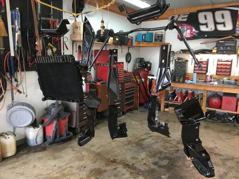

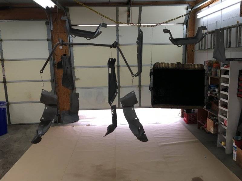

Final stages of painting. Today I painted all the remaining stuff. Inner fender covers, bumper brackets, and radiator. Radiator is going to be a little glossier than it should be but it will die back once it heat cycles a bunch of times.
Gloss level is supposed to be a little above 'satin'. Paint is wet in the pictures.

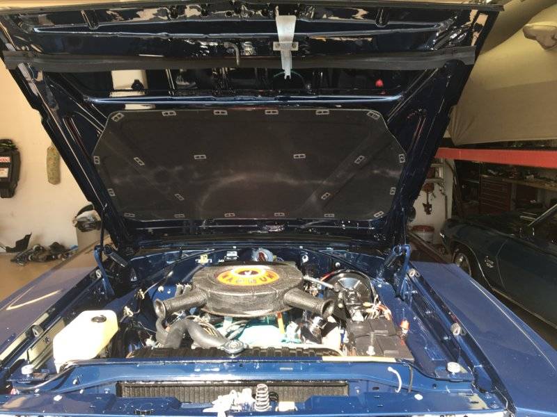

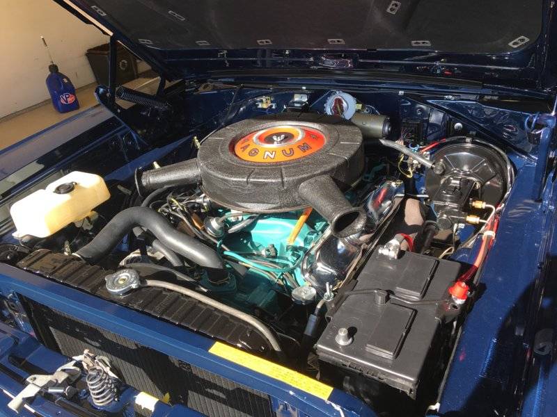

So I think the engine bay is done. Radiator and fan shrouds are installed.
Before pictures. BTW those are the same valve covers just clean.

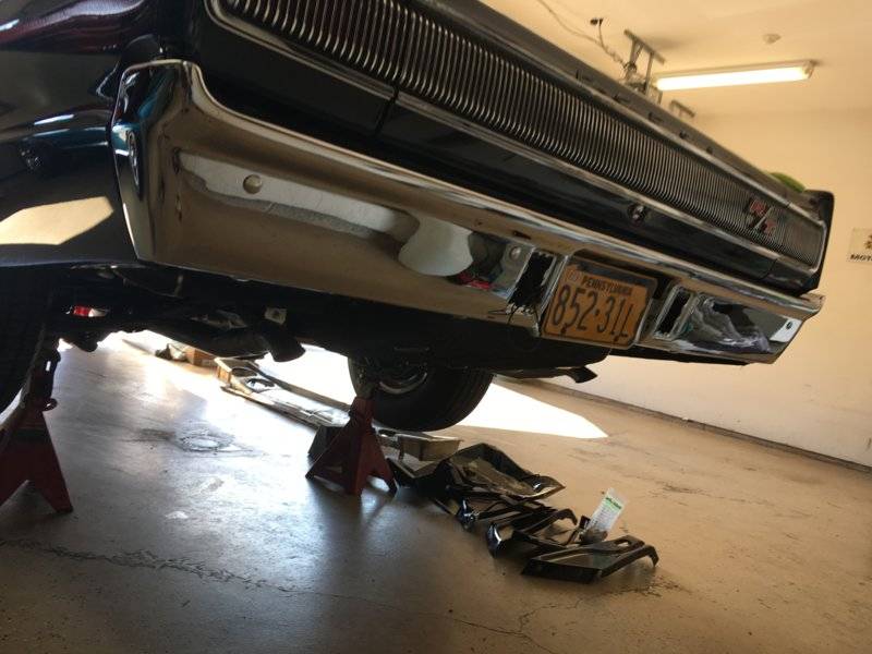

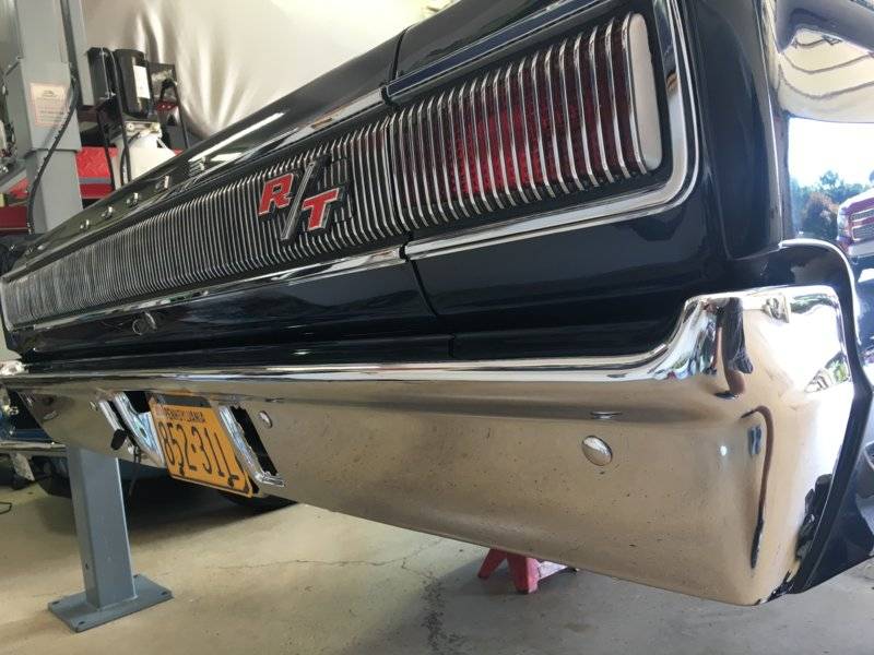

Rear bumper is all together and installed. I still need to recondition the back up lights. All bolts were cleaned and phosphated. Original bumpers replaced by LiBrandis.

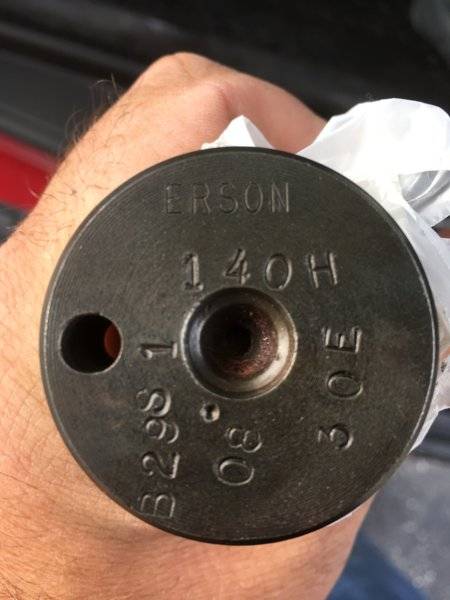

Alright, now for the best part... The car runs! I'm guessing but the car probably has not run since the early 80's until today again. I'm not sure if I told the story about the engine but I was told right before the guy who I bought the car from, they did a cam swap. They said the idle was a little rough. I figured there was no way that this person remembered this but sure enough when I took the engine apart it it had an Erson cam in it. When I inspected all the engine parts the cam looked new so it was reinstalled with new lifters. They were right about the idle too. This video is crappy, not sure why it didn't flip the right way but the audio is the important part.
Awesome car man really nice job on it congratulations on getting her running. Tail pipes look really nice to.
The Erson 140H cam spec's out as follows:
234° Duration @ 0.050"
302° Advertised Duration
0.450" Gross Valve Lift
110° Lobe Seperation
The 140H was an early grind (one of the first) offered by Sig Erson, available in 1965

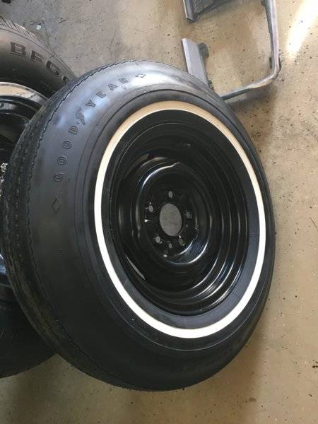

The spare tire was something that I wanted a good old tire. A friend of mine gave me a nice F70-14 redline Firestone. I'm thinking this is great, that'll work. Wrong. Tire was too big to fit in the tire well and put the cover on. Back to the drawing board.
After months and months go by I was doing one of my favorite things, searching Craigslist nationawide for parts. If found a listing in MN for a 7.75x14 WSW Goodyear Power Cushion tire on a wheel. This is the exact tire this car came with. I contacted the seller and I think it took him like 6 weeks to get back to me with shipping and then he had to setup PayPal. I'm thinking it's never going to happen. Well it did, when this tire arrived I was blown away. Previously mounted but the tire never rolled on the pavement, at least not on a car. No one repop she this tire in 14" so it's got to be the real deal.
I'm so excited for something that probably no one will ever see. Not only did I find the exact right tire but it's new and looks new. I'm done glowing.
