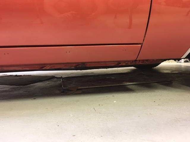

When I painted my 67 Coronet 20 years ago we left the rocker trim off. The car needed fenders, a quarter panel and a quarter patch. So I was left with holes for the molding clips in the rocker panel but not in the new fenders and quarters. For 20 years I haven't been able to bring myself to drill holes in the body but it's probably time to do it. It looks like there are 10 clips per side, 5 of them in the rocker. So I guess the other 5 are used between the quarter panel and the fender. Does anyone here know the location of the fender and quarter panel holes?

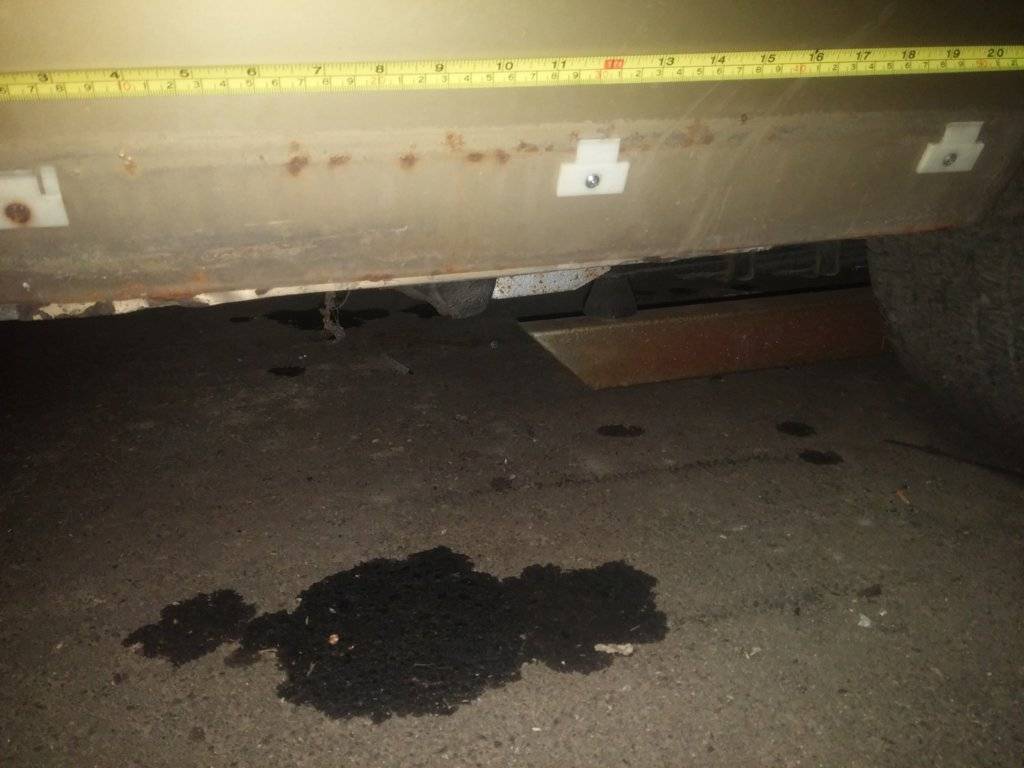

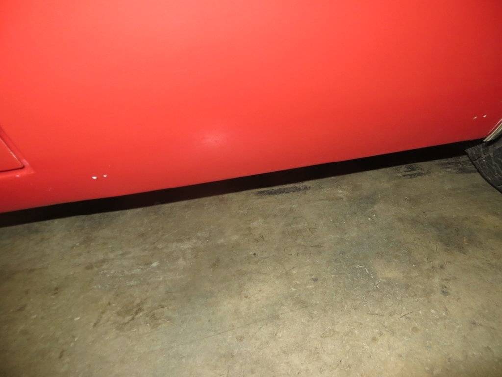

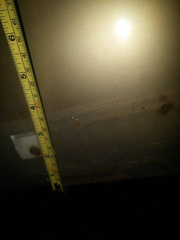

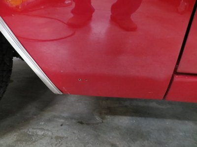

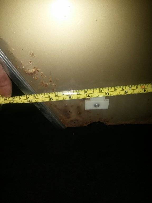

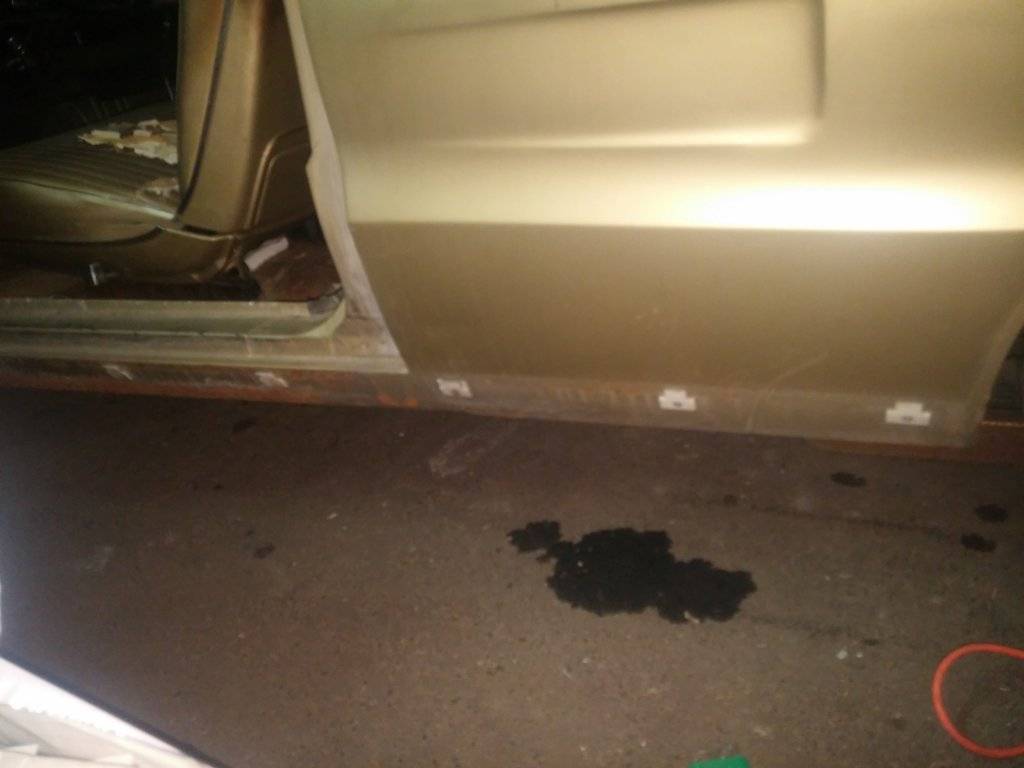

Just happen to be waiting on moulding clips so hope this helps. Only 8 per side, one on fender, 5 under door and 2 on rear of door, hopefully these 2 pictures will help. My clips have been backorded from Yearone and Classic industries and don't know when they will be here. If you can find them rather quickly please let me know. Also they are in the same line across as the door holes. jts
Thank You so much! I was going to get the clips from RT Specialties but I see he's out of them too. I guess like a lot of resto parts they all come from the same place. I waited 20 years, I guess I can wait a little longer.

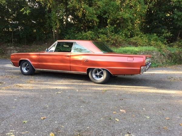

Done!! After 20 years finally complete. Thanks to everyone here for help on locating the holes for the clips.
Did you go with the 8 clips per side or 9? Very beautiful car.... looks super with the rocker moldings!!
Why are the clips so small for such a big/wide molding?? I thought the clips would have been bigger. I have the moldings for my R/T but no clips yet. Not at that stage of the game.
They only hold the top part. There is lip inside of the rocker molding that snaps onto/over the clip (like a french cleat). The bottom of the rocker molding wraps under the car about a 1/4" to 1/2" and there are screw holes in the bottom of the rocket molding to secure it up from there.
