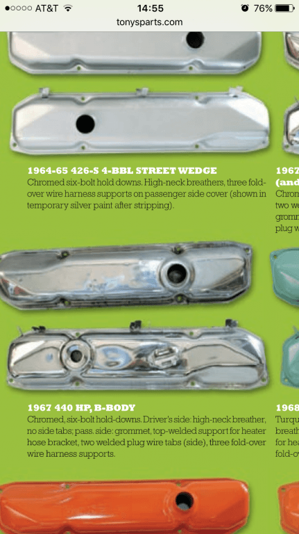

looking to replace my 67 440 valve covers they didnt polish out as well as I like. I saw many 68 ,69 440 crome covers for about 100 $ less than the 67 in the pics I can seem to see a difference does anyone know if their is one ? thanks
67 no tabs on driver side valve cover with high neck breather on b body only
