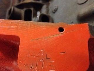

I just picked up a 68 440 last week and it has the vin stamped right above the water pump inlet across from the distributor on the large flat surface.

really? weird! the whole VIN? can you get a pic?
Sure, hopefully I am talking about the right thing.
Yeah, for 68 should be on the back of the block like you said. If nothing then might be a replacement block. Not sure if they got restamped.
A VIN on the front pad?? That would be a first for me.
That doesn't look like the VIN. There will be info there but it's engine size, assembly date, letter code for installation year (should be D for 68) and other markings. Look like whoever stamped that was trippin.

whoops, I see what you're talking about now. I thought that was it, sorry bout that. Yeah, It isn't as neat as you would think... No idea what the M is other than marine block which is what we assume... The side of the block is stamped 8/2/68.:eusa_think: I also just looked over mine in the places described above and couldn't find any VIN.
