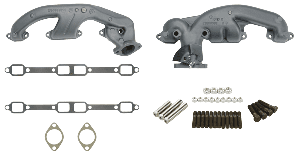

Has anyone used HP 440 manifolds on a 75-79 B-body ? I am considering a set of these reproductions for my 77

I don't see why they won't work. It sure looks like the exits are just about the same as the stock manifolds, that's usually the important part. It is possible that the drivers side might get closer to the brake master cylinder than original but if you put in a 79 style (it's smaller) you'd be fine for sure.

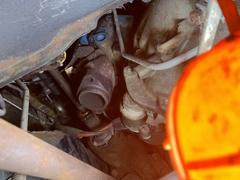

This is my current manifold on drivers side. It measures 2-1/8 ID :wtf:
