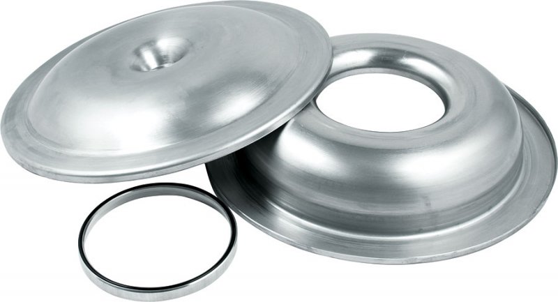

I'm starting to get serious about building a 451 motor for my 69 RR and need some opinions on hood clearance from you that have run this setup. I picked up a Edelbrock RPM intake off Craiglist and will be using a 1/4" spacer under a Holley 770 Street Avenger carb. I just went through a major headache with my Charger, 440, and a RPM getting an air cleaner that would work. Ended up with a 2 5/16 K&N, K&N filtered top, and a 1.25" drop base with no hood pad, and having the entire choke horn milled off. From the measuring I did yesterday, it looks to be just about as bad as my Charger setup was. Should I stick with the RPM, or is there a better solution out there that I don't know about?

I had to use a low profile air cleaner with my RPM manifold.
I tried that same set up on my Charger, but got a little more clearance with the K&N that I eventually went with.
