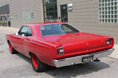

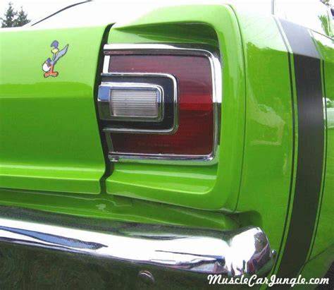

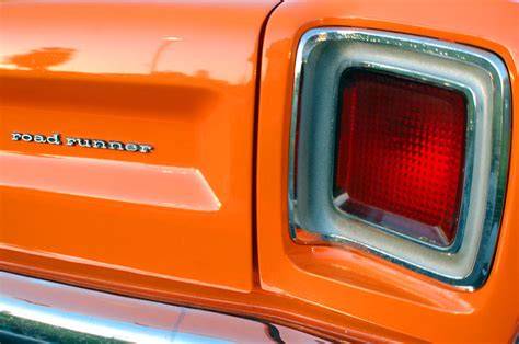

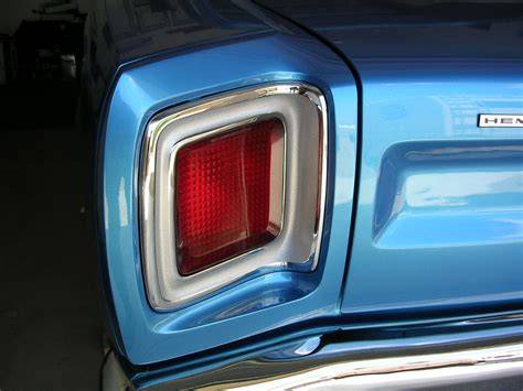

They interchange. But are different in the rear cove area obviously.
I'm not sure what you mean as the cove area , if you can clarify that I'd appreciate it , I have found many people call the same thing by different names depending upon where they are from so I don't want to assume.
Thank you
different on the rear facing area, where the trunk panel goes on.
