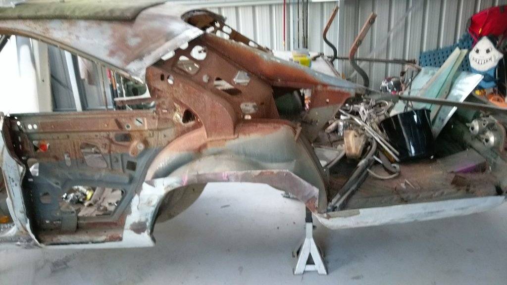

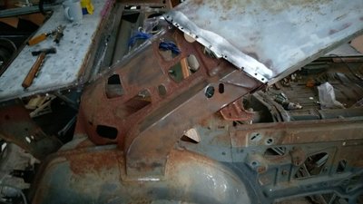

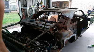

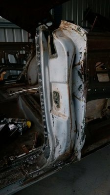

guys any tips on getting all the surface rust off in the nitty gritty places of the inner panels? inner roof has alot but i dont think a wire wheel will get in there?
