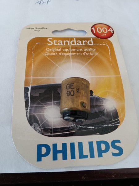

Had to replace the console bulbs as the one was burnt out. The both had GE 90, 2 pin bulbs.
Went to the local auto store to see what l could find. Best we could find was a 1004 B2. They work but wondering what if l have the right bulbs in them.
Thanks in advance!
The 90 looks like it's still readily available. Were they out of stock at the time?
Thanks! I'll look around some.
They had a limited supply but l figured they might not be made any more, or now some other number.
I wouldn't use the 1004. It is a 13W bulb and the 90 is a 7W bulb. Too much heat could melt a lens or socket.
I would look for a LED equivalent. Much brighter and less heat.
Went over and picked up the correct bulbs this am. Appreciate the help guys.
