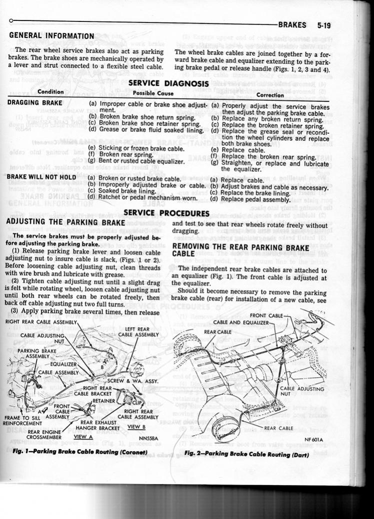

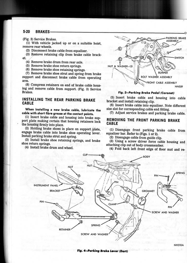

Hi guys recently bought a new park brake cable for my charger because original was missing, when i went to install the other day i noticed the parts to connect it were'nt there either, i was hoping someone may know where to get them, a diagram of how the cable is fixed to the pedal, any info would be greatly appreciated.
I have a '68 shop manual for a Charger I am working on, I will look and maybe scan some pics for ya......
that would be really good thanks for that, its just that the pedal assembly is right up against the kick panel and i cant really see how to unbolt assembly, i know the cable housing has to get fixed to the bracket with the bolt and plate, but i cant seem to see where the end of the cable fixes to,
Hello, I found some information on the parking brakes, it is about 2 pages with some diagrams. I will scan them tonight and post them here.
Parking brake
Here is the scans, hope they help....
