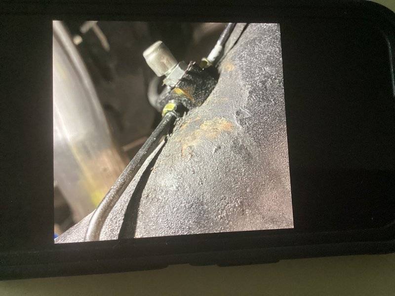

The crusty pic is my rear end and the brake line distribution block.

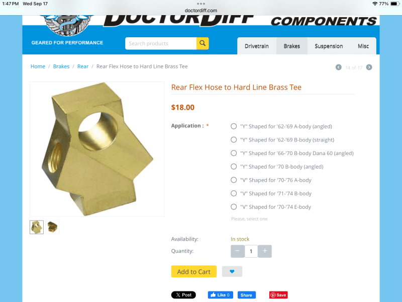

The other pic is what I think a new one is from Dr Diff.
The hole I see in the new block does it act as a hold down bolt as well as vent for the rear end ?
If not what does the cap on the block do ?
Thanks
Depends on rear end,8 3/4 yes 8 1/4 has a different vent. Its on the passenger side of the axle
8 3/4 fitting on the drivers side.
Tracking down brake lines I knew there was an axle vent but couldn’t find it. Never thought of a dual function vent/ hold down bolt.
Thanks Dave.
