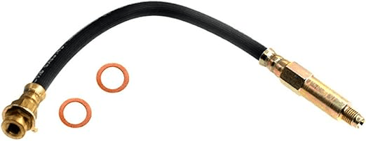

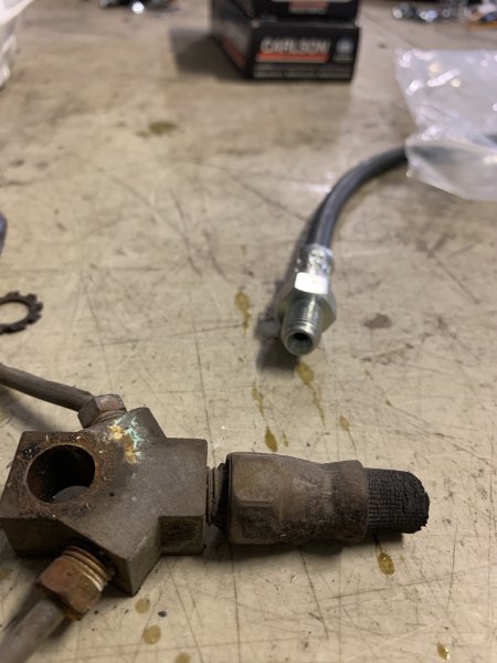

I haven’t changed a rear hose in maybe 15 or more years. Can’t recall about a washer, but I’m surprised one would be used with an inverted flare. You don’t use them on other joints with inverted flares. I do need to put my new stainless line on the back that I bought from inline tube. I’ll have to open it up and see if it came with a washer.
Of all the cars that I have owned, parted out and worked on, I have never seen a washer used between the threads of the hose and the brass block.
If the threads on the end stop right where the one above does, how is any washer going to help?
