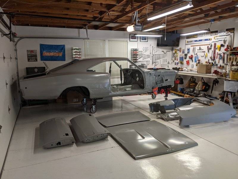

Hello All,
I'm looking for some front disc brake kit advice. I'm building a '68 Dodge Charger resto-mod. The motor is a BES Racing built 6.1 liter Gen 3 Hemi, will make between 550-600hp. I have taken it apart completely and am now in the process of putting everything back into it for a mock up before I send it off for paint and bodywork. I doubt I will put anything larger than 16" wheels up front. I'd like six piston calipers and am considering Brembo or Wilwood, I'll be running an aftermarket power boost set up - likely the Mopar blackout series from Wilwood. The suspension will be updated FirmFeel components across the board, 1" torsion bars, etc, but NOT a coil over setup. Any advice / thoughts / pitfalls to watch out for on a good front disc brake setup would be much appreciated!

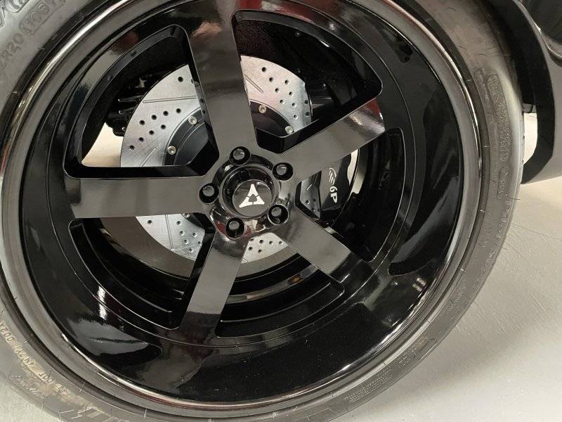

This thread made me think of this video I ran across recently... might be worth a peek. He discuss aftermartket brake setups, rear bearings, etc..
Yes: I installed a couple of the "little" Wilwood setups and they look nice but I think you SHOULD do better with a near 4000lb Charger.
Well Chris beats his cars pretty hard and auto crosses them, so I guess you have to decide what you are going to do with the car. I have agonized over brakes for awhile, to get really good calipers under 15" wheels are at best a challenge. I know Chris says he has NASCAR calipers that work but he doesn't provide a lot of info on them.
I bought a complete Wilwood front and rear kit for my 71 but if I am being honest I am not real excited about it, the calipers while I am sure are competent for street driving I do not think will take a lot of abuse especially in a heavy car. To get a caliper under 15" wheels you have to use a rotor of 12" or less generally (lots of variables here), but then you have to find a caliper that will accept a smaller rotor (11-12" is considered small these days). Then of course is the mounting aspect but this can be overcome if you have some fab skills. The other issue is if you find some nice big piston calipers (AP, Wilwood, Brembo) that will effectively work on a 11-12" rotor and clear the wheels can you get street pads for them?
Perhaps a part of the problem is that we want that "big brake" look when in fact perhaps some of the "little" brake kits will work fine for street driving. The merging of the big brakes and 15" wheels is the main issue, if you are willing to go to 17+ you could make a kit that would work fine but there would be some fabrication involved.
One day I will solve this, but that isn't today... lol
Thanks for all of the input fellas, I went with a set of SSBC that will fit under a 15" wheel. We'll see how they do. SSmoothie, that is a beautiful '68! Love the wheels and the brake set up, that may be where I end up in the next set of upgrades...after I get the thing on the road. Great YouTube video too - that guy is amazing, he's living the dream...he's forgotten more about working on cars than I will ever know.
