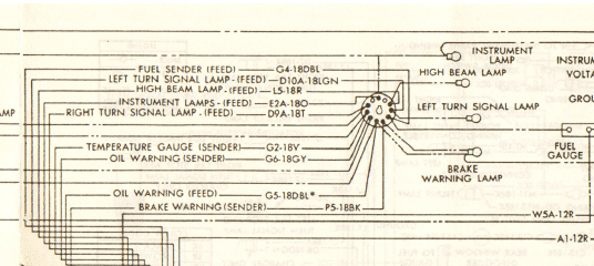

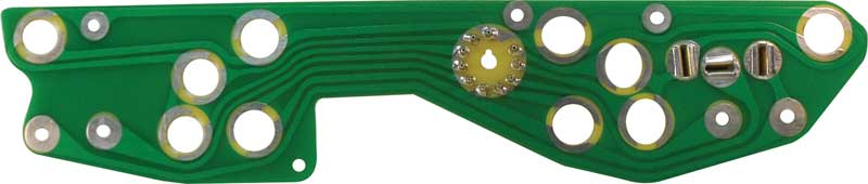

I swapped out the speedo in my 68 Coronet. Gauges work fine, but only 2 lights work.. and radio light. The other lights for the fuel, etc do not work. Any guesses as to why? Is my board fried or is there something I'm missing? I've checked all the bulbs and they work fine.
Thanks for your help. Much appreciated.
So the bulbs work but don't light ?? Confused ... did you swap bulbs around to check if they're good ? What about the sockets ?
The lights are fed power through the pin connector so if you have power on a few you should probably trace the circuit board for a broke or burned through circuit. And check continuity through the wire to the pin connectors as they can lose contact. The orange wire at 12 o'clock is the lamp feed.

Thank you very much guys. I will pull it out and test the board and connections.
Assuming worst case and there is a burnt or broken circuit.... how do I repair that? Are they lights in loop sequence?
Thanks again. Very much appreciated.
You can solder in a jumper wire to go across the broken contact points on the circuit board if needed ..
Or,just maybe; bend the 2 socket contacts upward for a better contact to the circuit board. ( it’s a stretch I know)
Thank you very much guys, pulled it out last night and turns out one of the light sockets wasn't making contact. After testing with a jumper wire, the rest worked fine. A little bending persuasion and she's good to go lol. Thanks for your help. Much appreciated!

Make sure the orange wire going to the cluster has voltage with light switch on ..... I'd start there
Thank you, I'll try that today. Where does that orange wire get power from? Where should be my next test?
Fuse box, to headlamp switch .... do you have access to a wiring diagram ? If not you should get one, it'll come in handy more than you'd think !
