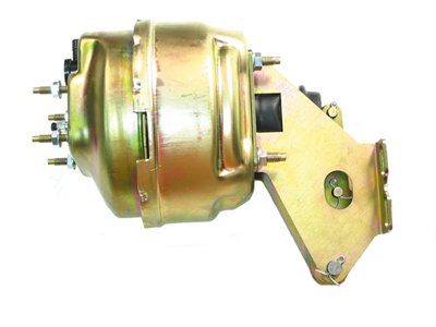

I have seen what could be described as "longer narrower' boosters. They are not as big in diameter. Don't know the brand name but they are out there. You would have to study them to see if one would work in your situation.
You can install a hemi brake booster bracket, raises the booster just enough.
http://www.theramman.com/component/...dy-booster-bracket-combo-detail.html?Itemid=0 Or
http://www.boosterdeweyexchange.com/ Or
http://www.ebay.com/itm/like/331109388021?lpid=82 $25.00

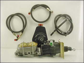

Or install a hydroboost system, runs off your power steering pump if so equipped.
http://www.vancopbs.com/category_s/66.htm
