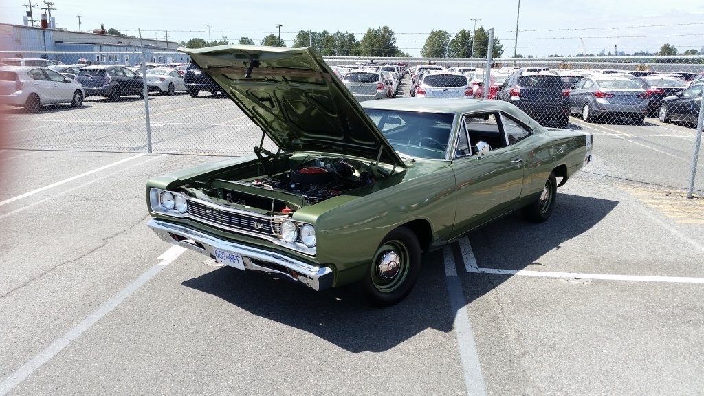

Back, towards the firewall.
Not sure if this helps. 69 RR hood but should be the same config.
Thanks, Shorthorse. Just replaced the seal on my 1968 Road Runner. The seal was missing when I bought the car and spent quite a few minutes figuring how it went on. I knew FBBO members would not let me down!
