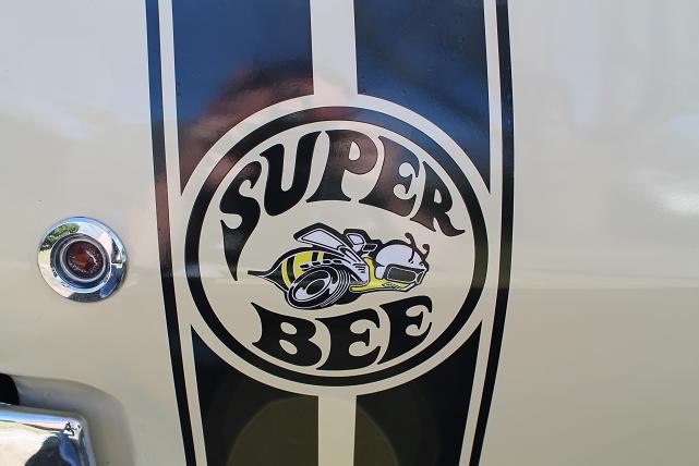

Right on prop, any idea of how far forward they need to be from the side marker lights?
3/4 off the marker light is very close I think. Just did my Superbee and it works out very good but take your time and do not rush. If I have sometime tomorrow I can measure and get back to you. I think the stripes would be in the same possition just without the "Bee" on the quarter.

Looks like Milit73 took care of ya Bones.......
