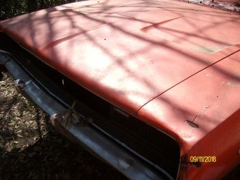

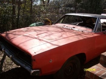

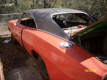

68 Charger Pics
Thought you guys might like to see some happy snaps of this 68 I am questions about.

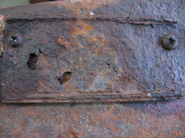

Fender Tag or whats left of it
Looking at most of the fender tag on this Charger is pretty much looking at a pile of rusty dust,but I can make out some of what's left of it. The sequence number on the bottom row to the far right is still discernable as matching the VIN number on the dash stamping (begining of the VIN is XP29H8B). The other numbers that can be made out are 411, 62, 486 and possibly but not 100% sure but it looks like 473 but it could be 418. I looked at the 4 speed hump and shifter assembly when it wasn't so freakin cold out and the hump itself and it looks original to the car. Generally when a conversion is made 1 way or the other (727 to 4 speed or vice versa) many times who ever swaps the humps doesn't bother to drill out the factory spot welds and spot weld the new hump in place in lieu of just fitting up the new hump and running a few stitich welds with a MIG welder or gas welding it in place. I've got a 71 Challenger that I know for sure was a four speed car but a previous owner must have decided to do some track time with the car and changed it from a 4 speed to a 727 automatic and then installed a set of Hurst Lightning Rod shifters and the hump for the auto was put in with sheet metal screws and liberal application of roofing tar (talk about a chore to get off).

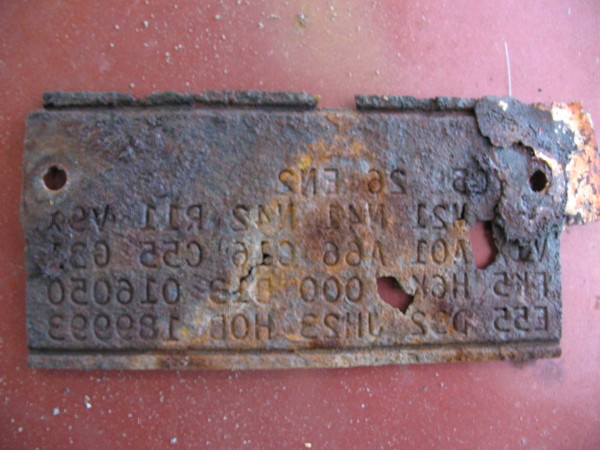

If the fender tag is still attached take it off and flip it over, you should be able to read the codes from the backside. I would consider 1 of 259 pretty rare.

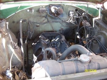

AC or Non AC
Firewall that is on this car at this point in time is definetly not for an A.C. car and whomever has done any work on this car in the past has a hodge podge of parts and pieces stuffed in the passenger compartment trunk and engine bay from 68, 69 and 70 Chargers AND an Oldmosbile. The weather here is a little warmer here today so I poked around and unloaded some of the stuff inside it to see what I have inherited. Got both a 68 and a 69 grill for it. Lower quarter panel patch pieces with the rectangular side marker lights that is definetly not for this car, a power seat track, the reverse facing side scoops with the R/T badging from a 70Charger R/T, 3 air cleaners (1 of which I know is off of a 69 Oldsmobile that came equipped with ram air that was ducted from under the bumper), pair of seat headrests and an intake setup for 2- 4 barrels with a paper tag on it marked 383, what looks to be a set of valve covers off possibly a big block Chevelle and 2 sets of heads (both completely stripped down). That is about as far as I've gotten digging through the larger stuff. The only thing that would hint at this car being an original A.C. car was the guy who dragged it over here mentioned that the guy he got it off of told him when he started working on the car that it was setup for A.C., what is left of the fender tag and in the trunk was dash controls, compressor,condensing unit, under dash air plenum. Hard to determine on this car what is what on it. I haven't put it up on a lift to check out the under side of the thing but there is every nearly every color in the Mopar book on the sheetmetal of this Charger (Black,Red,2 shades of Green,Blue and Orange so far). Best find I have come across so far are 2 rally dash clusters that are in excellent condition and a door, actuator and hood trim strip off of a 70 "B" body N-96 air grabber hood.

Do you have the buildsheet? If so look for code "411". Oh the dash pad also does not have AC vents.
It is very rare (I have one) and, at least to me, very desirable. Out of approximately 74,886 XP's made only 333 were 4-speeds; 259 were the 4-bbl and 74 were the 2-bbl. In '68 there were 17,584 XS's (R/T's) made and 2,954 were 4-speeds. Try to get the fender tag numbers listed. From what you have already listed it is a 4-speed (tag code 62), built April 11 1968 (tag code 411). That is a car worth saving. :yes:

Just for clarification, the picture above of the fender tag is NOT the one for the subject post. When I first saw it I thought is was until I went back and looked that the member names. it is a 1970 car and the coding is completely different then the 68 cars.

Sorry 696pack, I didn't meen to throw you off course with my fender tag, I was just trying to drive home my earlier point. I wonder what became of the car?.
