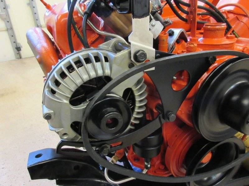

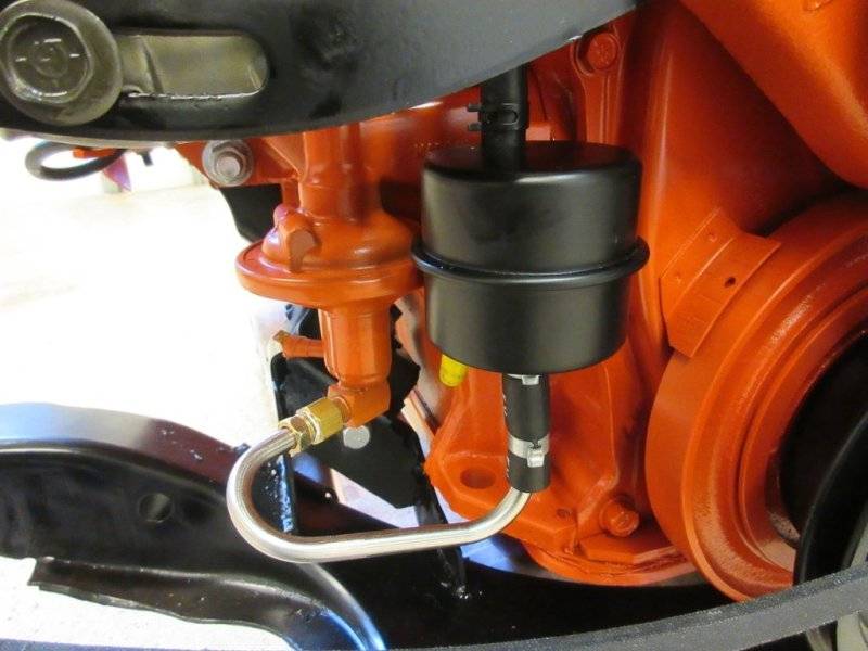

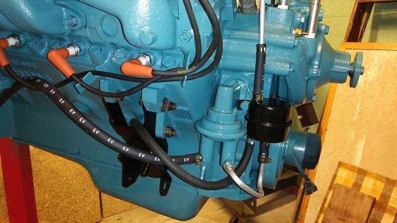

And I found it in the 68 service manual on page 14-56 for 440 and 426 engines. What confused me is that it doesn't show a line to the tank, but just notes it. I guess I need to read more and not just look at the pictures. Also should this be a three piece metal line from the pump to the carb (pump to separator, separator to filter, and filter to carb
)? If anyone could provide a pic that would be greatly appreciated. Thanks,
Here are some:
