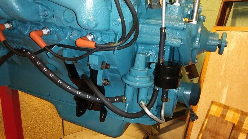

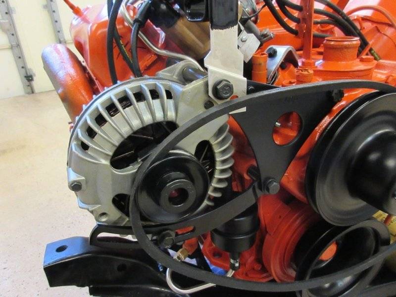

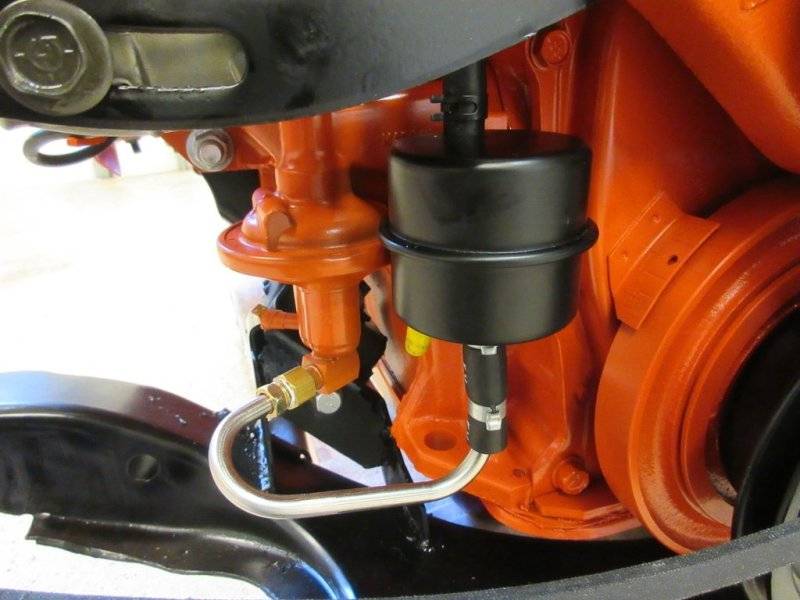

Hmm looking in the service manual it shows one where the vapor separator is located Fig 44 page 0-20. So if it has a vapor separator then a screen is used at the carburetor?
Yup, either a filter, 383 & LP 440 or vapor separator HP 440...
Yeah, I go on our site and on Google Images and grab pic's for reference so I can put mine
back together! You helped without even knowing! Thanks.
