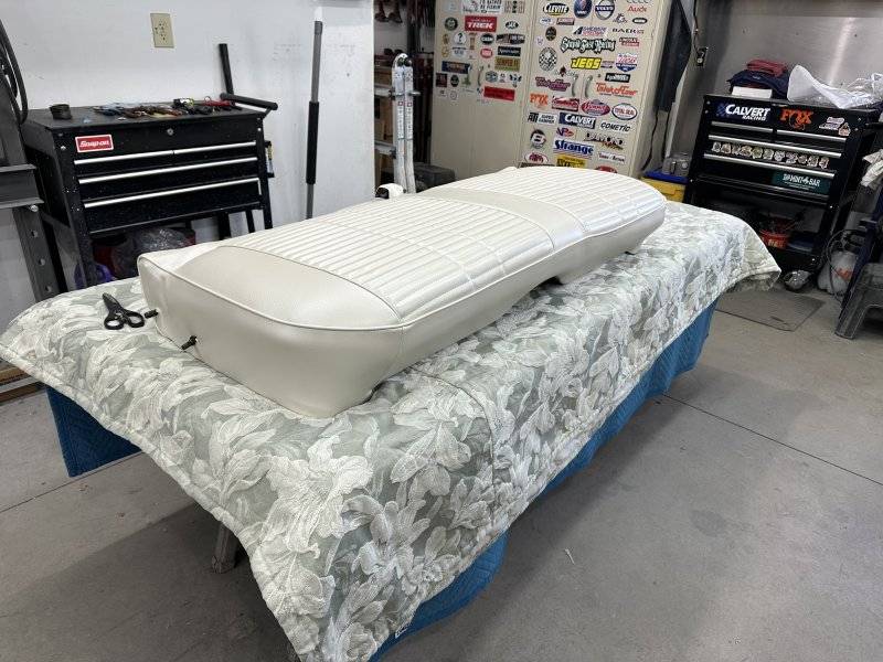

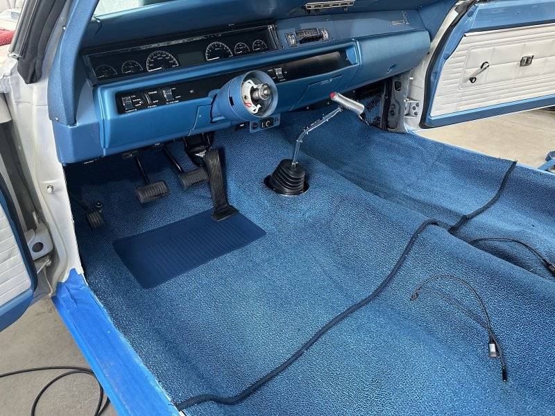

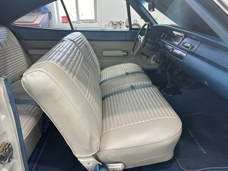

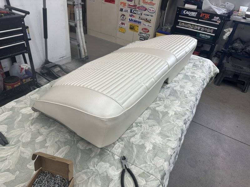

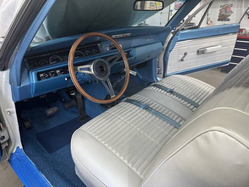

Slogging away here on interior. The décor pearl white interior on this car has presented some issues as it is fairly rare. No demand hence proper repo parts are not available.
My youngest son and I (72 B5 Duster) will show side by side at the Wyo Tech show June 1. I have a month left to get this junker in shape. I should have the interior in by this Sunday.

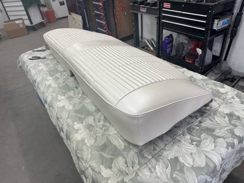

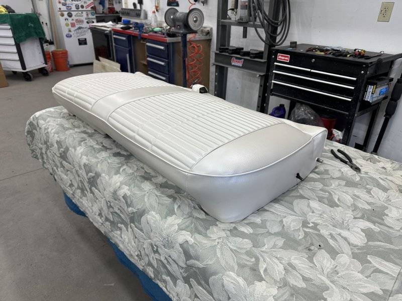

Stretching upholstery on is damned hard on my arthritic hands. It sucks to lose hand strength. I had to purchase PUI covers instead of Legendary. Legendary was a year out, PUI was 3 months out. I have installed nothing but Legendary over the years and their stuff is top shelf. However the PUI covers are pretty damned nice save a couple of minor details. They are still made in the US. They’ll do nicely. The first two pics are the rear bottom, the next two are the front bottoms. A good hot 90 degree day should make things relax a bit.
Pulled the seat medallions off the old covers from the back rests. What a bitch. I will move the rears to the front and the fronts to the rear for obvious wear reasons. Freshened them all up with a light dusting of “Herbs” pearl white vinyl paint.

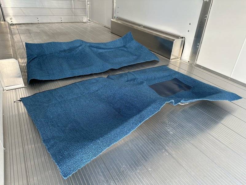

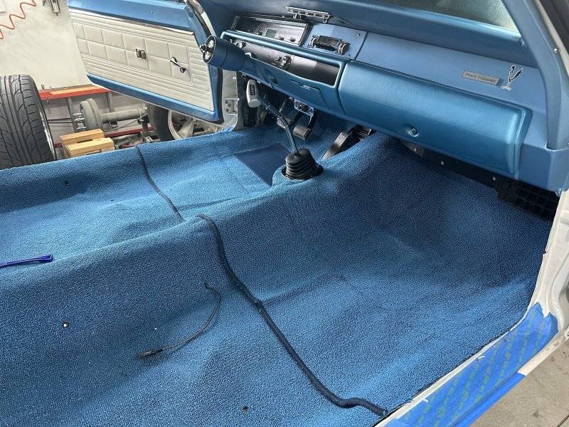

Carpet relaxing out in the trailer.
**** below.

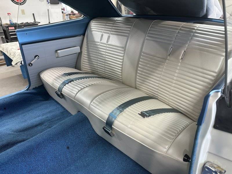

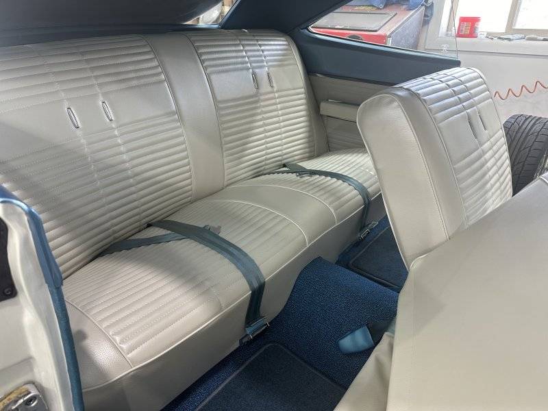

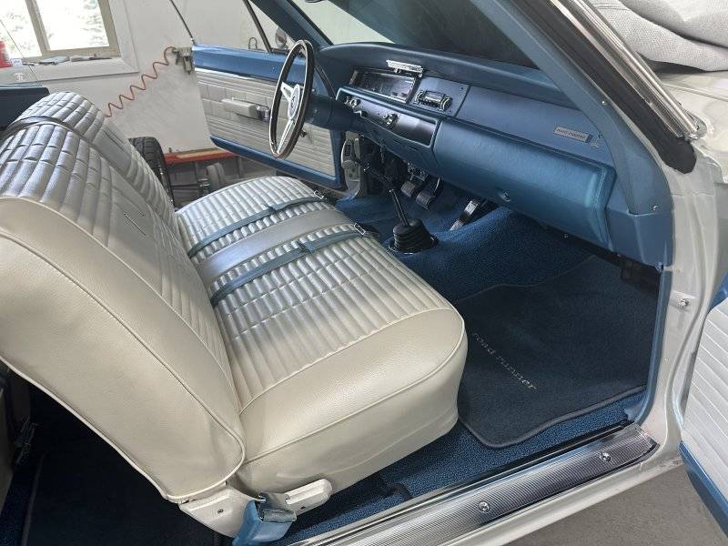

Pushing hard to get the interior in this weekend. It's been a bit since I had to play with the rear seat in this car but I don't remember it being the hard @ssed bitch that was today. Maybe I'm just old and week these days. I had to resort to the 'ol back in the door jamb, left foot low, right foot high and leg press this F@cker in. Thought I would surely tear something, on me, not the upholstery.

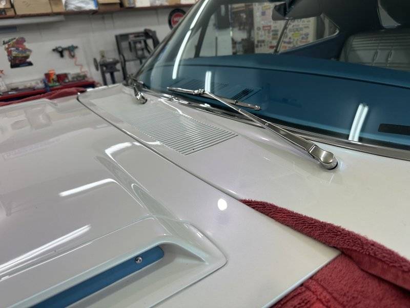

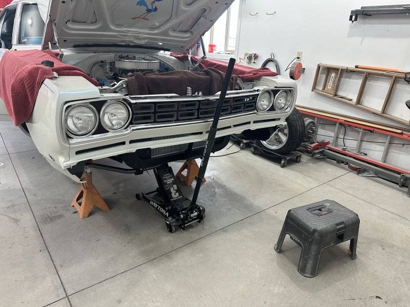

LED headlights and polished wiper arms in. Should wrap up the front seat tomorrow barring any Oh $hits.
What a nice, nice combo, and an unusual one too. How many cars will you see at a car show with a white and blue interior? Likely none.
It looks bitchin'! Love it! :thumbsup:
I’ve had some seat bottoms go in just as you described and I was wondering if it was just me getting old and weaker.
FYI; looking at the picture, there seems to be a slight bow in the seat back. Grabbing the bottom of the seat back and pulling it forward will get that bow out.
Love that blue white interior combination.
:thumbsup:
:thumbsup:
Thanks RC, I think I'm just old and weaker.
I was unsure if that bow was was natural or not. It's been a while since the interior was in. I'll give it a try. I also noticed that the driver side front seat back is a little tweaked as well. Too many hard launches back in the day I suppose. I'll get in the back seat and try to un-tweak it if I can.

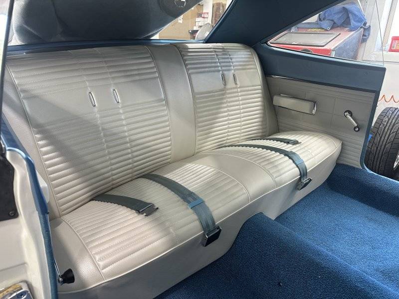

Got the rest of the interior in over the weekend. The front seat back covers were by far the toughest to install. Not quite perfect but close enough for the girls I go with.
I have found that the decor pearl white upholstery varies a bit or is almost impossible to get. The door panels and seats are PUI and match perfectly. Legendary is a year out on this color. Had to paint solid white armrests and seat hinge covers with the pearl white from Herb's. Close but not perfect. Not sure if I like the floormat color I chose or not.
Waiting on some help to put the front bumper on, after that, I think I'm pretty much done save an alignment, test drives and dealing with any gremlins that will pop up.

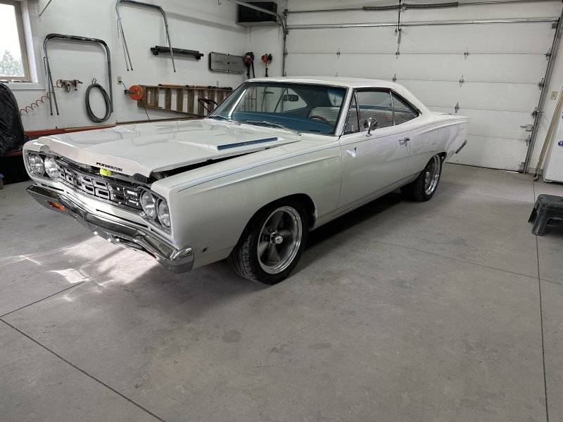

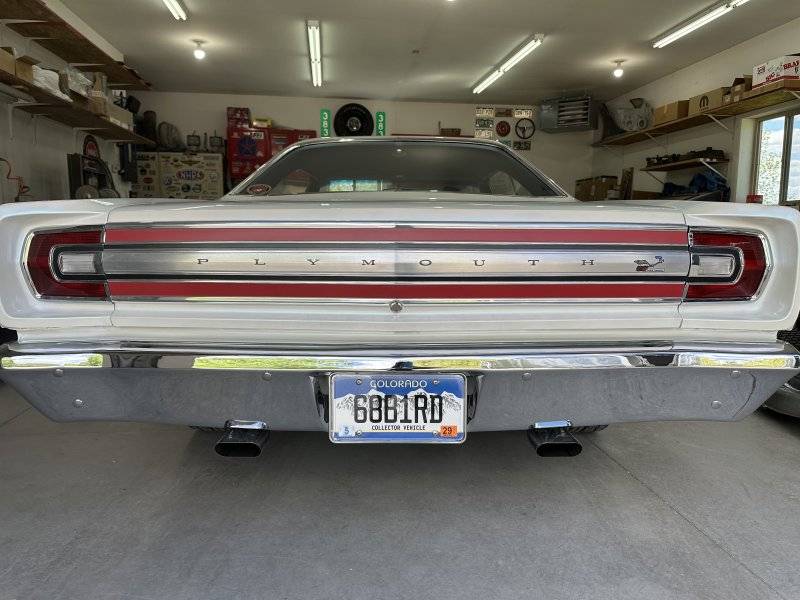

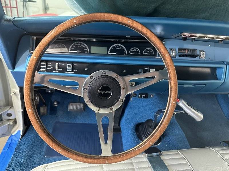

Shake down drives today. Several short loops around the cul-de-sac getting the T-Bars dialed in to where the front's weren't rubbing. Then a couple of laps around the neighborhood produced some rattling in the CalTracs as the mono leafs settled in. Tweaked that out. Then a 4 mile lap around the section to calibrate the Dakota speedometer. Feels like a brand new 1968 Mopar B Body overall. The brakes still need seasoning. Need to play with adjustments on the shocks and tire pressure a bit to smooth things out. A few small whirs and friction sounds of 100% new parts settling in together for the first time but by and large the day was a success. No leaks!!
Alignment scheduled for this Tuesday. May drop the front a bit more at that point but as of now we have "two full fingers" between the upper inner fender support and the shoulder of the tire. Tight. The rears are breathing easy and are set right about where I want them. Odometer showing 3 miles at this point. Can't wait until it shows 500 miles so I can drop the hammer. Hopefully my 62 year old reflexes are up to it.
First pic is the christening before the drives. Second pic is chilling after the days work out.
Wish we could post videos like we used to but I get the reason.
