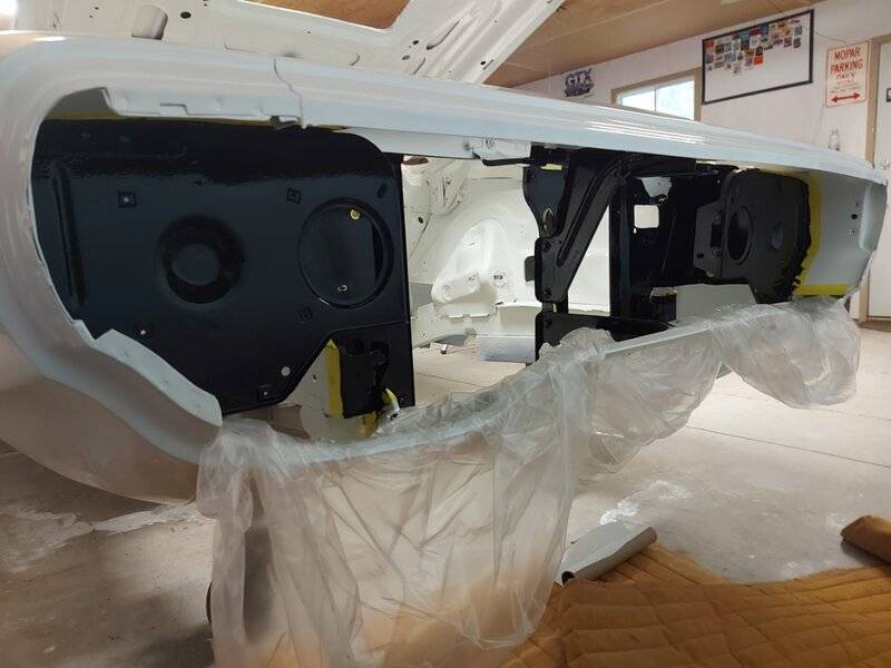

Blackout treatment done over the weekend. 4 Hours of masking, 20 minutes of shooting.
Good job Runner 68!

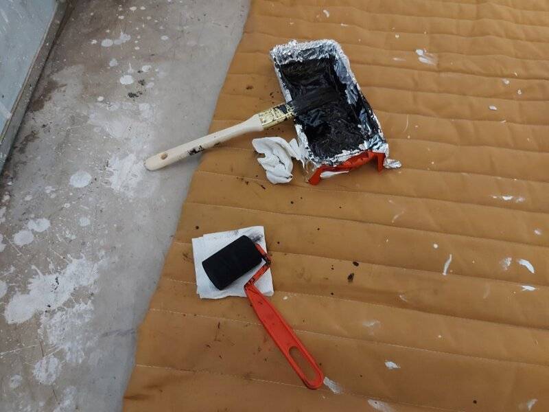

I just finished doing the same on my 71 Runner.
But I didn't spray, I used a small foam roller along with a 1" wide paintbrush.

Well it sure in the hell would have saved a ton of masking! Great idea. How did it flow out for you?
Actually, it wasn't bad at all. The paint I used is called Tremclad which is the US version of Rustoleum. I used semi-gloss black. The trick is the foam roller.
Once it's rolled on it does level itself. The finish will never bee the same as spraying it, but alot of it will be covered up with parts once assembled.
