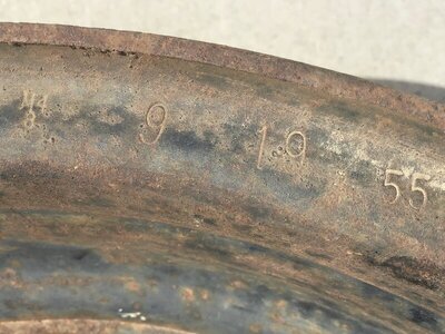

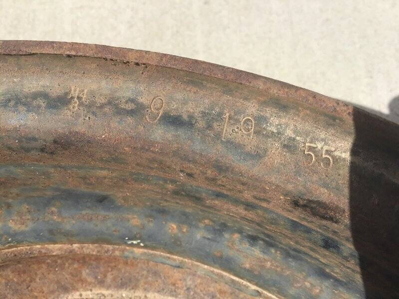

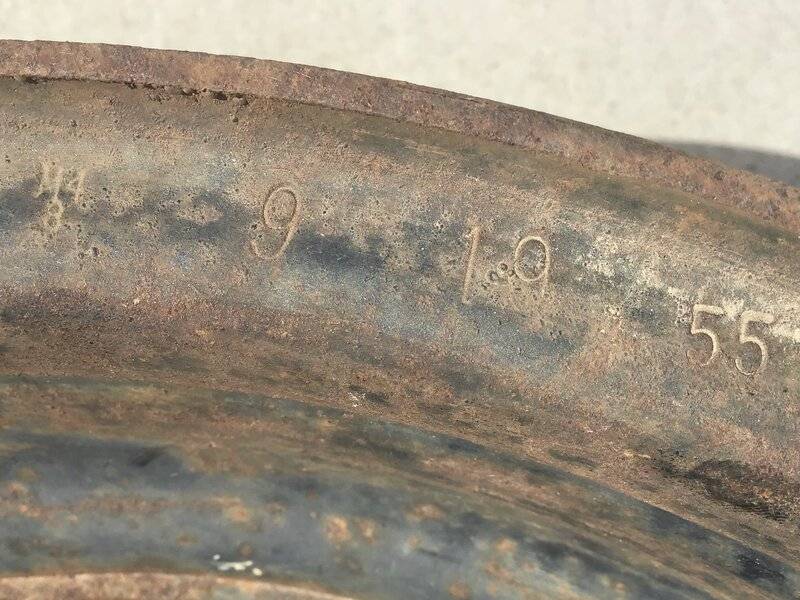

On the early 1969 road wheels built in 1968 the dates are on the back side rim edge, where the weights go. Get a magnifying glass and a wire brush to see them on unrestored wheels.

See photo of what you are looking for on the date stamps. This is on the back side rim edge where the weights go 9-19-1968. This is a true 1969 road wheel.
They stopped making 1968 cars in mid July 1968, and started making 1969 production cars sometime in early August 1968. This is all depending on the plant.
View attachment 1274961 7C246D56-0553-4366-8623-0353A9AC276F.jpeg C4F8061C-1B9E-48C2-A3DD-C26D21415E1A.jpeg

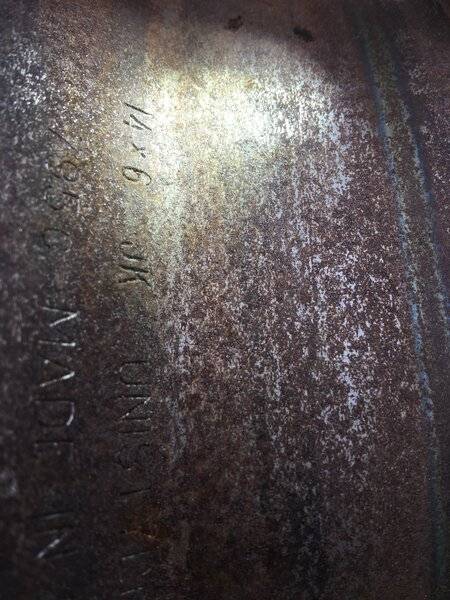

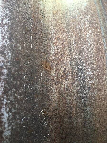

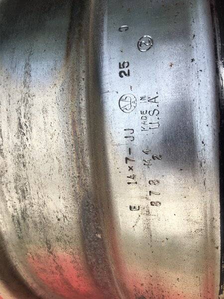

I have some that came in my convertible guy said they were original but they don’t seem right ... I think mine where aftermarket add ons. They are however chrome.
1C1F08FF-0C15-4DED-AE9B-76F0F8D724CA.jpeg D18F368C-051F-4B08-A0F9-197CCB6462C1.jpeg 3DEC1255-A5BF-4028-8768-D647D8BDFAB0.jpeg
