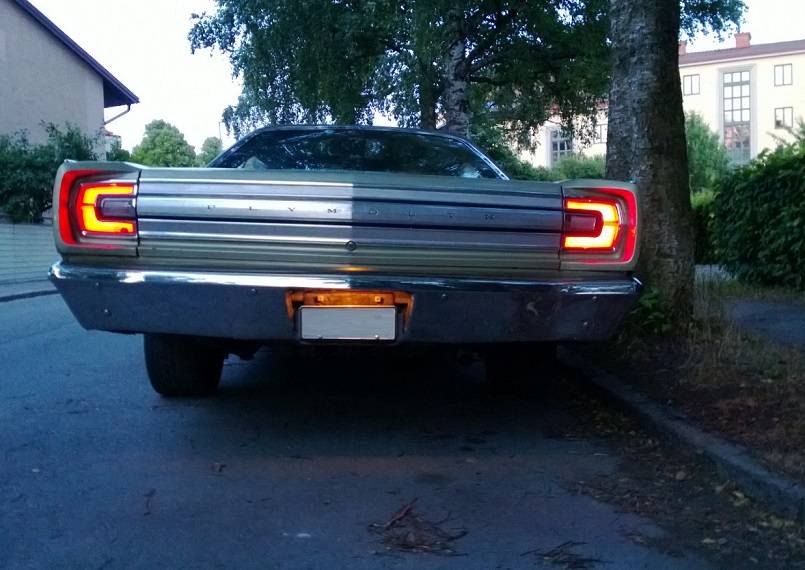

View from behind. When car was parked outdoors, I first figured the leaning was in the road, leaning towards he curb.

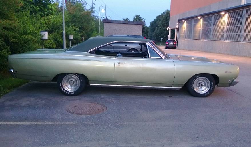

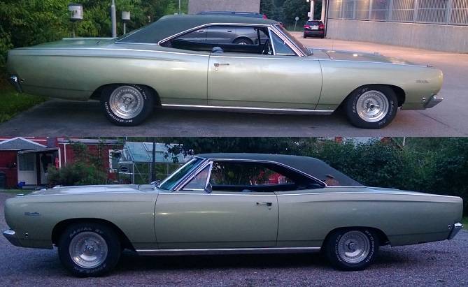

Side view. While the attitude is kinda good, the car is way too low - I've had ground contact when riding slowly over speed bumps and paving. Those are 14" tires, btw - I believe I'll swap them for 15".

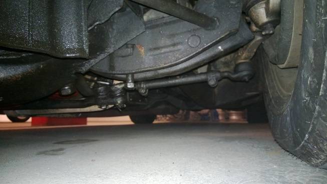

So I took a peek underneath, trying to localise the t-bar adjustment bolts. Is that the one sticking out just to the left of the middle of the pic?

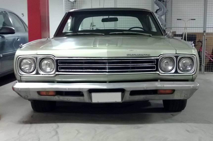

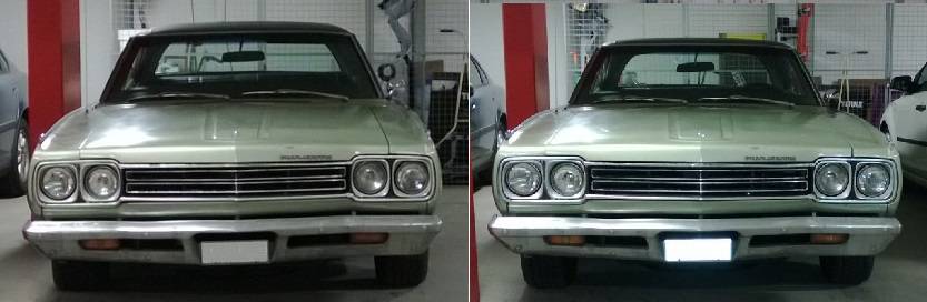

If so, that would be the other one. Does it look like the right hand side bolt is sitting lower than the left? I've understood from reading the forums that the bolts needn't be sitting on egual height, but this looks like a bit too much of a difference.
Right now, I can't even get a normal jack under the k-member or even the rear axle, so placing the car on stands is not possible until I manage to raise it. Are those bolts the adjustment bolts? What other tips and advice would you offer when it comes to making the car ride higher?

Get a service manual to get the specs for the ride height, and adjustment procedure. Those bolts do adjust the ride height, and can have different protrusions depending on torsion bar condition and temper. As far as the rear goes, the ride height looks fine to me. You can have a slant depending on the leaf springs you are using. I had hemi springs, and mi slanted a little too.

You have the correct bolts Identified, just need to get some tension off them (jacking the car) to make adjusting easier. As far as how much?...there is no set amount (i.e.: 2 turns equals an in). Just have to experiment until you get the height you desire. Good luck!
Cletus, those are, indeed, the bolts for adjustment. It appears someone has turned them out quite a bit--normally, only the heads of the bolts are visible--and in some cases you have to look up into the recess of the lower control arm to see them. Popular rule of thumb is to measure the front ride height in a straight, vertical line from the ground through the center of the wheel to the fender well opening--common measurement is 27" to 28". Same method for the rear, common measurement is 24" to 25".

Went to work on the torsion bars, and everything went smoothly. Adjustment bolts moved with ease, raised the front first and worked myself down do a suitable height. Car doesn't slouch or lean anymore... rides with a way better attitude now.
