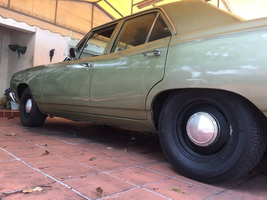

Well, things got just a bit wider today :)
-Kurt

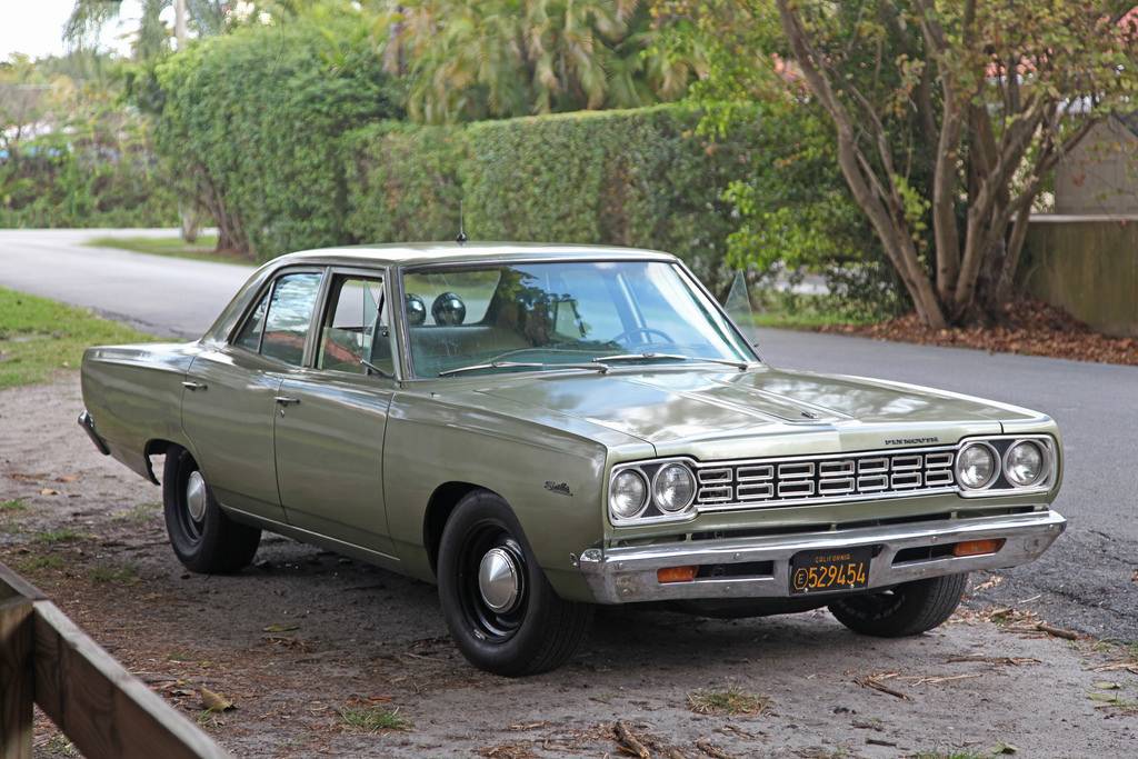

It was a busy day today! Drove about 40 miles north to pick up some '80s B-van rims from a gentleman who had them on his '70 Challenger.

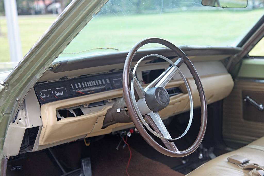

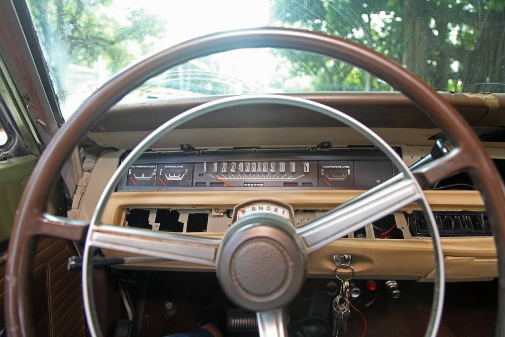

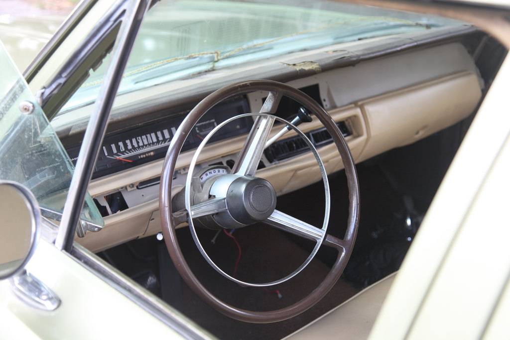

Threw them on, and immediately went to tackle the Belvederization of the interior. Yes, it's Duplicolor vinyl paint on the pads. Camo tan on the dash too, and neither matches. Deal with it, purists, it's what Craptastic Auto Parts had in stock! Admit it, there are enough factory jobs of this era that it doesn't look out of place. That, and I HATE dark interiors - this one is inviting, by comparison.
Also - despite all the bench testing and what-not...the fuel and temp gauges are STILL dead. Oh well, more to troubleshoot. At least I know exactly what I'm grabbing at behind the dash now.

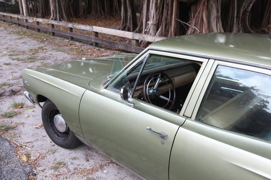

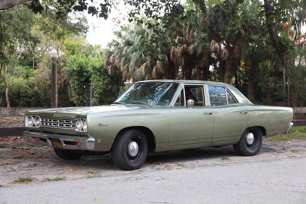

But it was no time for complaining - it was time for PICTURES! Went out specifically for a photo drive and came back with these beauts:
1968 Plymouth Belvedere (Satellite) - "Adam 12-1/2" by cudak888, on Flickr

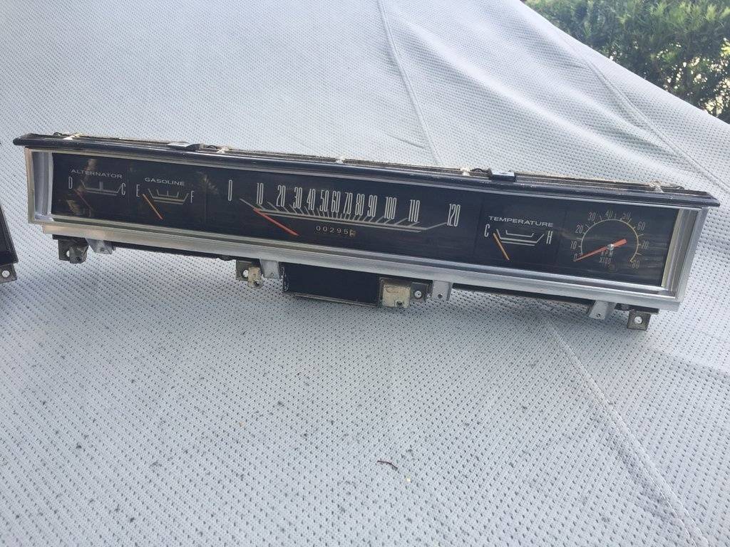

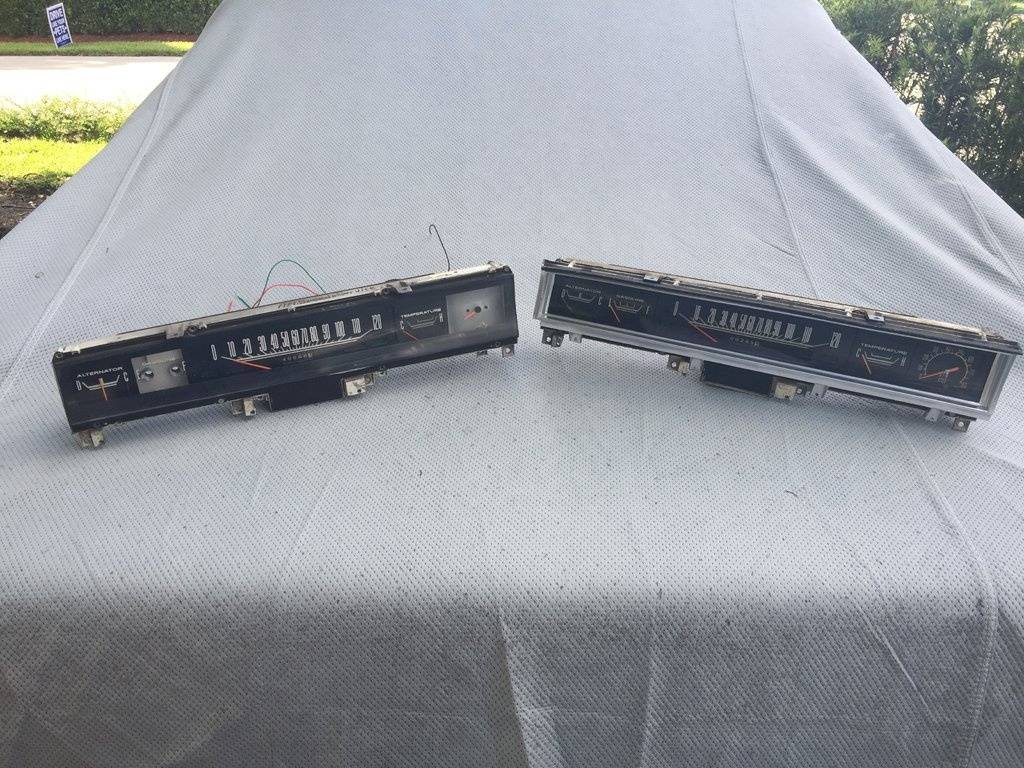

P.S.: Anyone have a Belvedere instrument cluster bezel/surround they'll part with?
-Kurt

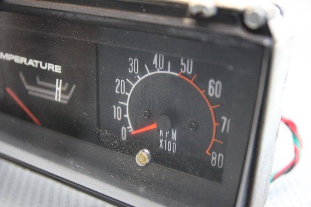

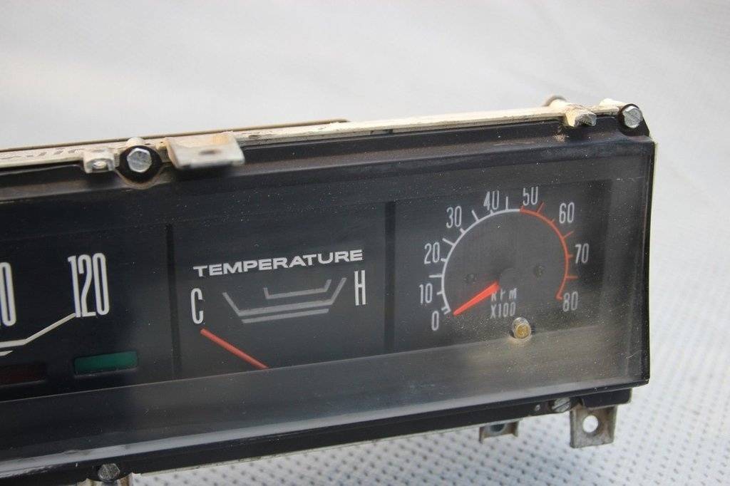

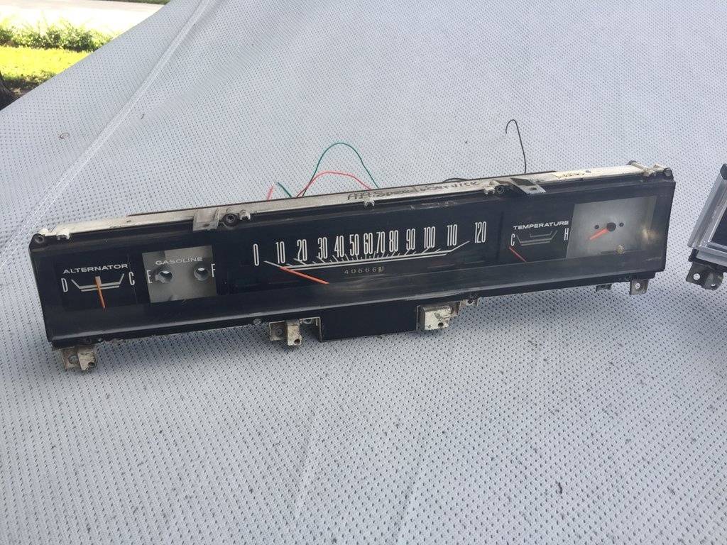

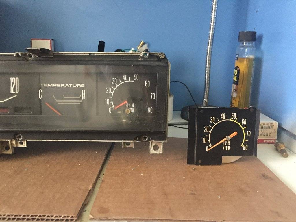

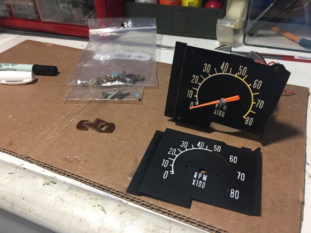

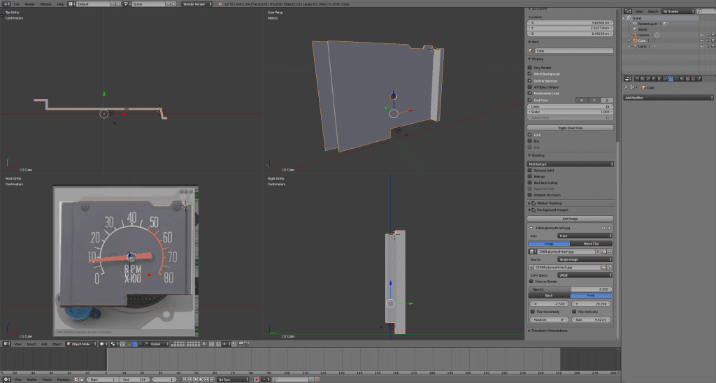

With the prospect of replacing the original fuel gauge and temp gauge with Sunpro units (Why? Cheaper and 12V; just a major pain), and the dimmer switch pending to be modeled for 3D printing, I couldn't help but start experimenting with the prospect of making one of these for cheap:
-Kurt

Just a thought. Could you pull the needle from a new tach and glue the housing to the back of the old tach faceplate?
I could even glue the new 3D printed one on the modern tach I chose, then tear apart an equally cheap oil gauge for the needle.
At that point it starts becoming not so cost-effective though in comparison to the new RTE PCB on the back of the original, since I already have the super-expensive bit (the original tach itself).
-Kurt

Gotta post a photo of the end result with the 3D tach, it looks great, but hoping to put the RTE board in the original.

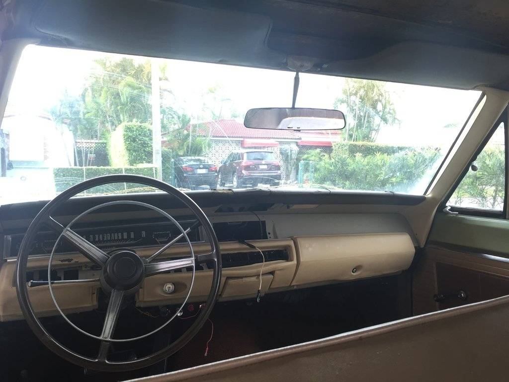

Half-success. Got the cluster in (minus tach), painted and installed the A-pillars (need to touch up the dash pad - it's been abused from all the instrument cluster work), and buttoned most of it up.

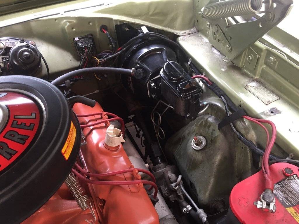

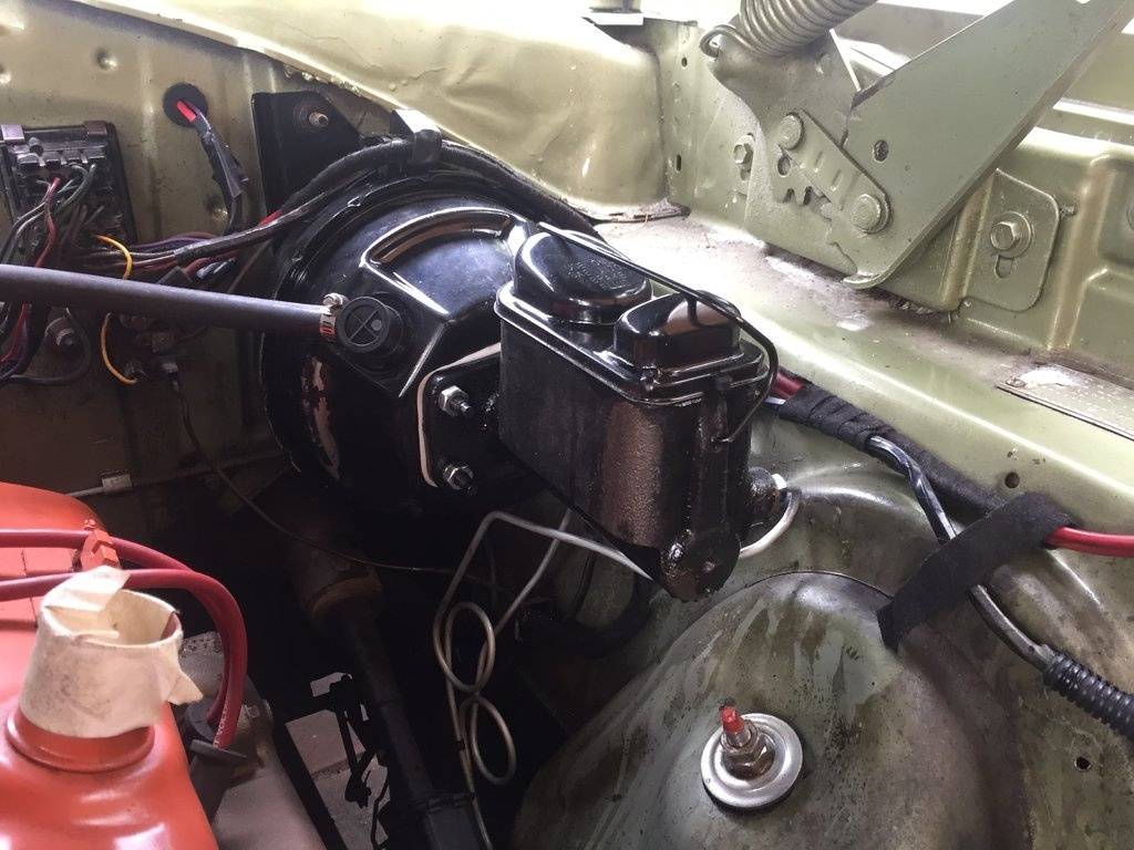

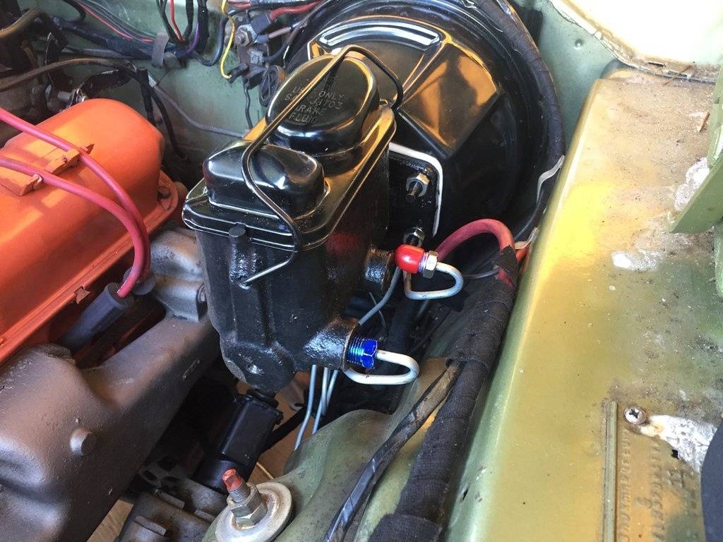

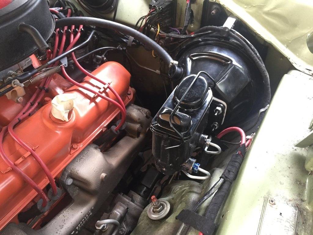

Just finished installing a new Pirate Jack booster today, which I bought from a forum member who hadn't used it on his own project. It took a while to complete the job, as I had to swap the rear B-van brake cylinders from the back to the stock units.
Was a bit ticked to find out Inline Tube's "perfect fit" lines needed a very tedious massaging for the rear brake line. Looks like crap now too.
That said, the brakes are dragging quite a bit, so I think the jam nuts between the booster and master need adjustment. Not trying it today though; already abused myself enough physically preparing and surviving Irma.

Inline Tube's perfect fit - meh. Not so perfect.
After modification:
