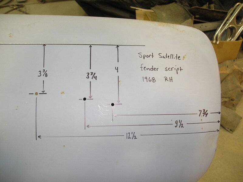

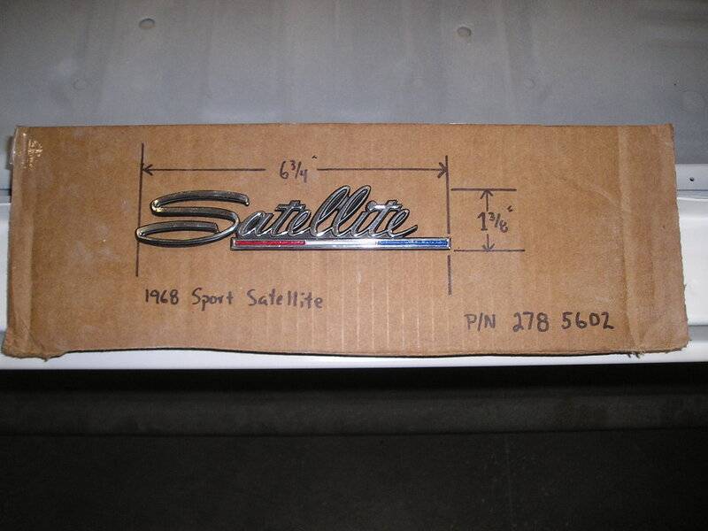

The previous owner of my 68 Sport Satellite was in the process of converting to a GTX. In doing so, he welded up the mounting holes for the front fender emblems. Does anyone have the hole location dimensions or can anyone take measurements and let me know the dimensions? Thanks, Larry
Unfortunately the SPORT emblem is not shown here.

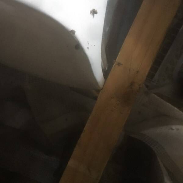

Sport Satellite sits lower, I will take some measurements.
My numbers here are from the back hole and forward, 352 down 109, 272 down 114, 225 down 124, and then the Sport above, 405 down 84, 341 down 82.
All measurements are taken horizontal from a woodstick in front of the fender, and from above I used the same black line.
0298_n.jpg?_nc_cat=107&ccb=1-3&_nc_sid=ae9488&_nc_ohc=CndycqV3-X0AX_cyWQt&_nc_ht=scontent-arn2-1.jpg
If you find problem at the drivers side just let me know.
Check them out first with a markerpen or similar so you can see they line up nicely.
