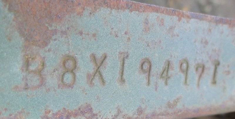

Thanks. What is the # on rad support
The stamping on the body shows the plant, the year, the model type (indicated first letter of the VIN) and the last six digits of the Sales Order number.
So B8X = Hamtramck plant, 1968 model year and Charger. 194971 are the last six digits of the Sales Order number.
