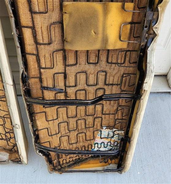

I hear ya. Mine is still in the back seat, but the paper is totally adhered to the seat springs and crammed up in the corner. It's too fragile to pull out. When I pull the springs, the paper comes with it and starts to tear. Not sure how I'm gonna remove it without major damage...
its like removing a stamp, or steaming an envelope open...
Wonder if dental floss no steam or with steam. Start in a no info area of BS. Maybe you can pull springs away from foam, maybe it would be a disaster. Mine came tight out, but my car was only 25years old.

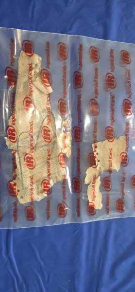

I ended up using my son's cool air humidifier and put a light amount of moisture into the zip lock bag ( 5-7 seconds worth) I let it sit for about 10 minutes and it was super pliable. I was able to easily unravel it and lay it some what flat. After a couple minutes it dried back out before I could get laid out all the way.

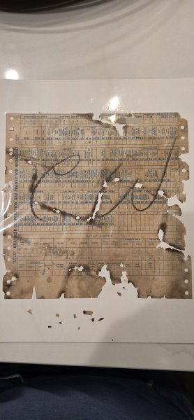

I found some 12x12" acid free magnetic photo album inserts to put the broadcast sheet in. I know it may not be ideal but it was the only way I could piece it back together without it moving all over the place. Fortunately I am able to read most of it after using Qtips to brush the dirt away. Thankfully I can read the sequence, shipping and sequential number.Not sure if being above the heater all those years was a good thing or not.
