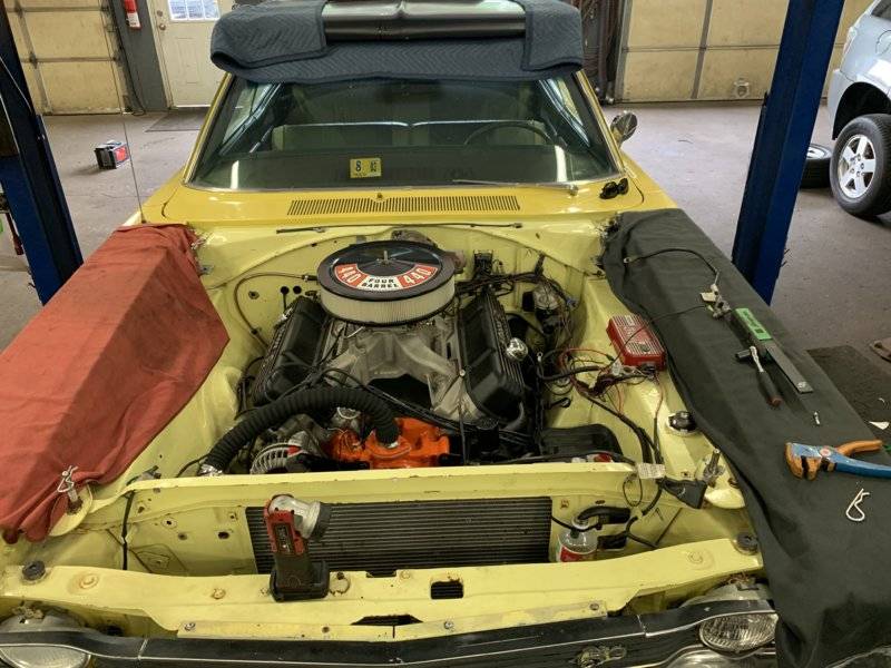

Also for posterity I will attach a photo of the engine bay as we have it now I do have some other pics of stuff if needed but they might not be super clear.

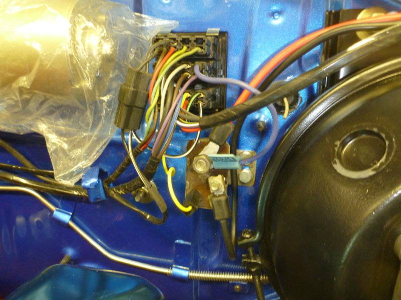

Is the fuseable link hooked up from the firewall starter solenoid to the firewall wiring bukhead? If so.. is the link blown?
I did not check that and honestly I didn't see what looked like a fuseable link. but would this stop all electrical in the car?
Edit note: I was thinking of the ballast resistor
I did an image search and found what it's location is and it was checked
The fusible link was replaced at some point and we did check it, it used a barrel fuse and it is good. It had no change.
Fuseable link is ALL power to the interior of the car.. and of course that includes the ignition switch. The heavy Purple wire..
I'm pretty sure that is my link, it was blown, we figured from arching the starter, and possible that it popped again.
