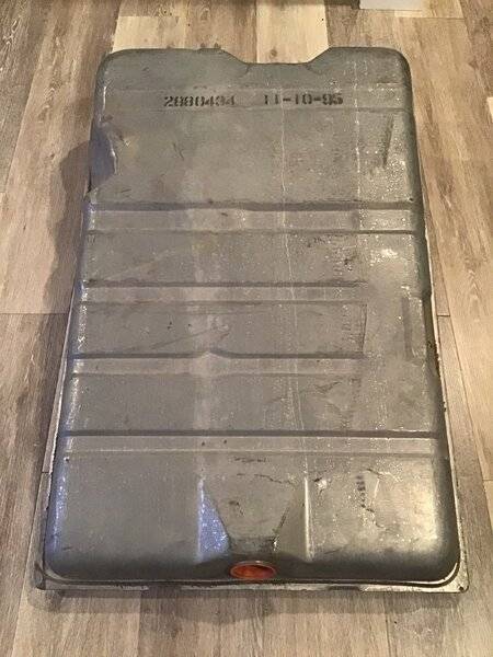

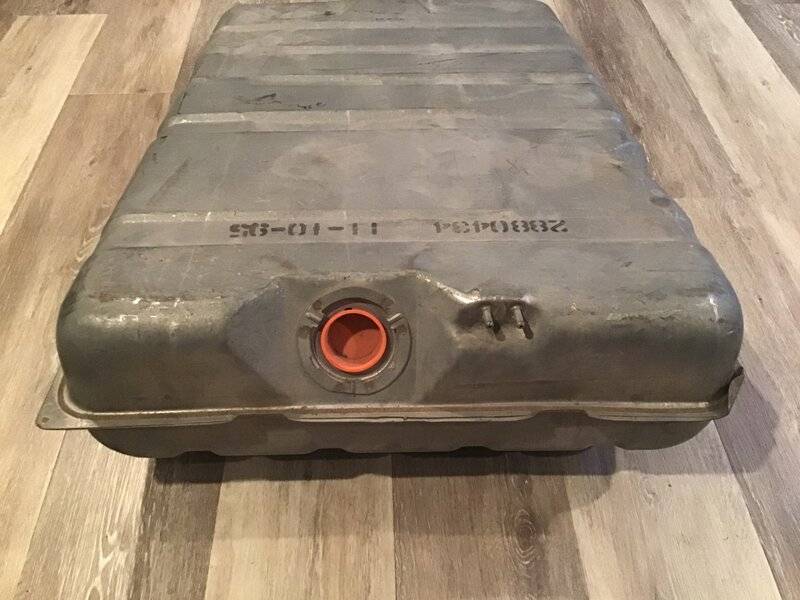

*** BUT AS NOTED BY MOPARSAVER... R and W (Bevedere and Coronet) the correct tank for a Roadrunner would be 2880 434 !
69 R and W shows 2880434 except Charger & station wagon. I have an over the counter replacement if interested.
