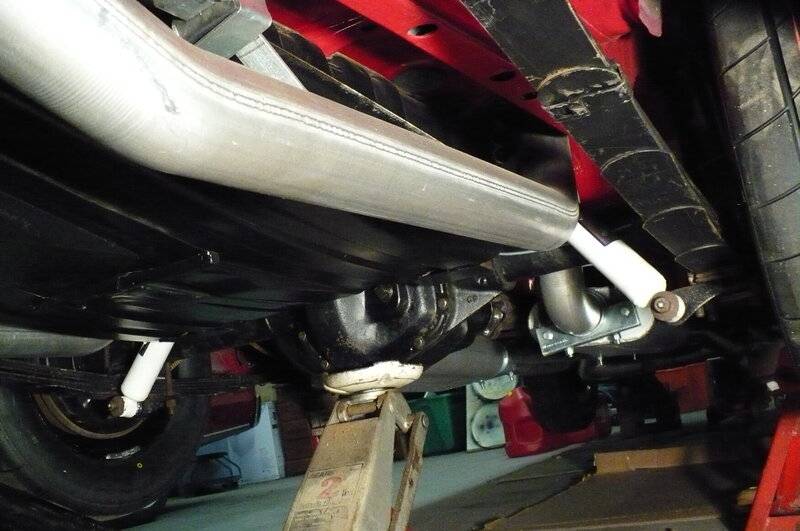

I have the 3" TTI on my 69 Super Bee. The only place it is tight is by the gas tank. I know I didn't pay $1200 for it either. Would I do it again? No, I would stick with 2.5".

TTI has you install the system starting with tailpipes then mufflers. Buy tailpipe hangers, they're (knife?) slip in. You can just see at top of picture.
