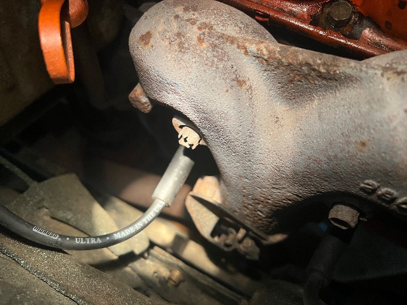

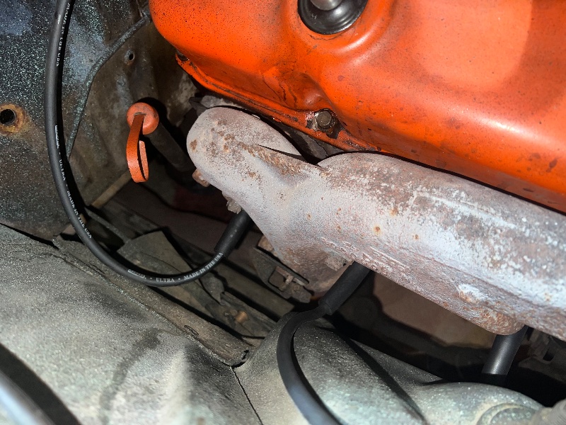

The 2 sleeve nuts on either side of the down pipe were rounded off when I got the Bee and I have an exhaust leak at the manifold on cyl 2 so I need to get it off somehow. Any suggestions on how to tackle this?

Well that's lovely. I think I might just take it to a dude down the street who does restorations. He says he has a couple tricks to get it off. But I agree, it looks like it needs something welded to it (either to the end or around it).
Do the threads inside the sleeve nut go the full length of the nut or just at the end where the stud is?

I believe they do Mikey. Lotta good suggestions by the crew here

If I do go the route of welding a nut on, I would think I’d have to drain the coolant so that it does not cool the stud down during the whole process, correct?

Maybe try heating the barrel sleeve with a torch, that should expand the sleeve off the stud and you might be able to back it out
with small vice grips. Make sure you have a good "bite" on the sleeve after you heat it before turning it out.
