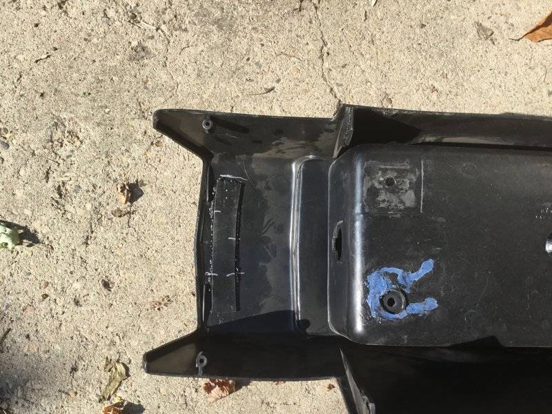

How I do it.
I find a plastics fabricator that uses ABS sheeting.
Got mine from the place where I used to work, we manufactured orthotics, prosthetics, custom wheelchair seating and orthopaedic footwear which was my department.
Got scrap black ABS, 1/8, 3/16 and 1/4” thick material.
Bought acetone/ fingernail polish remover will work.
Put some very small, almost like filing’s of ABS in a sealed glass jar with some acetone. Left it to sit for some days until it made a nice glue. You might have to add more of either.
Took a piece of ABS formed it to fit the underside contour of the console top.
Put glue on both sides and clamped it.
I have done a few this way, works!
One reason for breakage was people in the back seat kneeling on it to talk to the people in the front. There isn’t any reason for that to be broken. The 67 we bought in 1970 is still crack free.
You can see the reinforcement 1/4 “thick piece, and I added reinforcement to the tabs at the bottom uprights.
Now the cat is out of the bag!
I suggest trying to glue a few pieces or samples until you get the right consistency.
