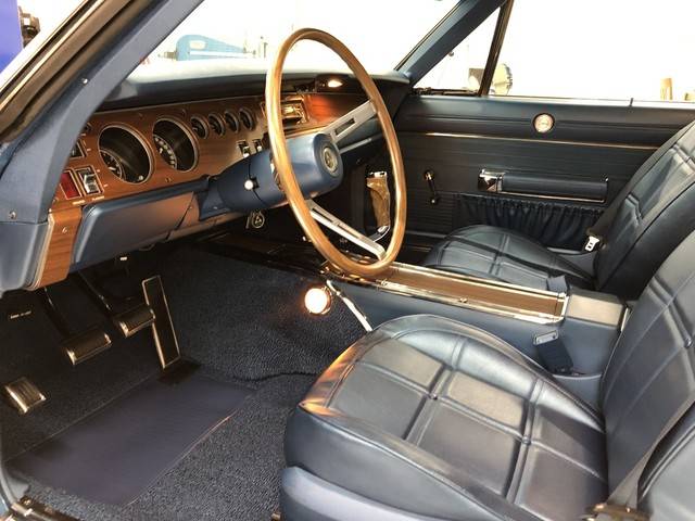

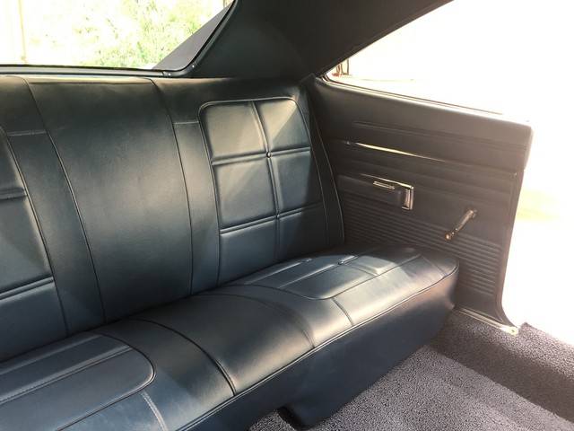

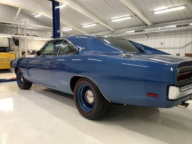

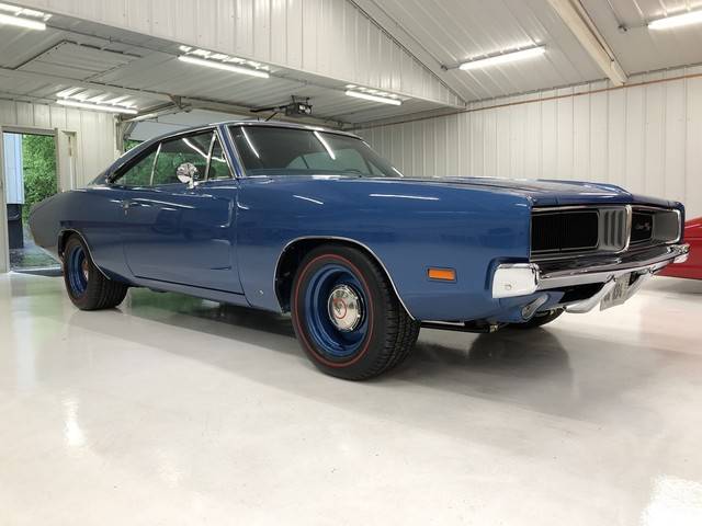

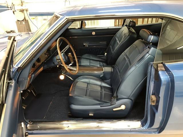

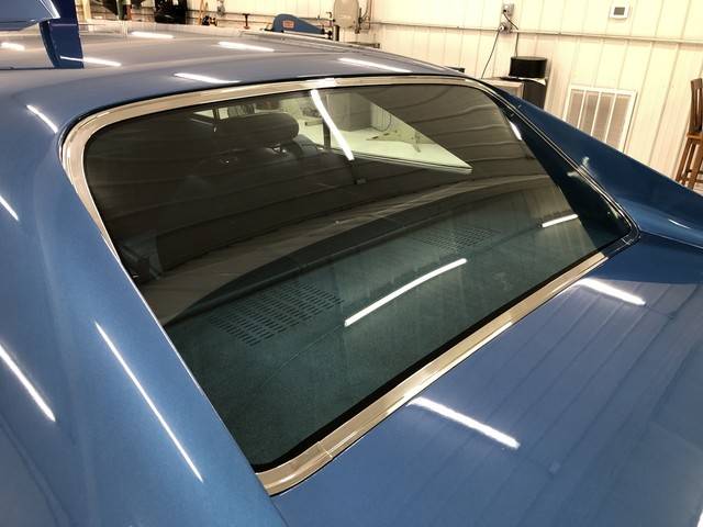

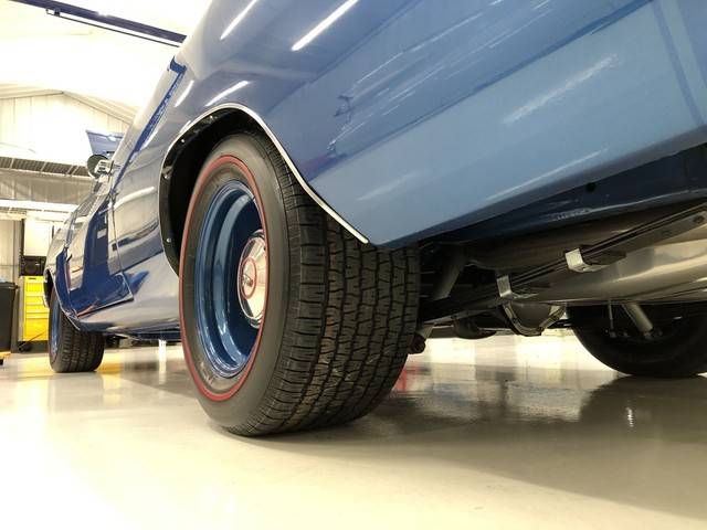

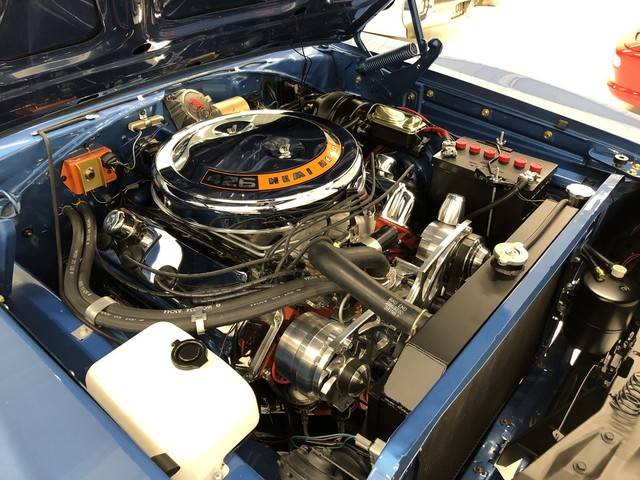

Seems I did a terrible job of updating this.
I am excited however as the car is nearly completed.
Just a few small details such as wiper arms, alignment, cut and buff. Also need to swap ring and pinion from 3.54 to 4.10.

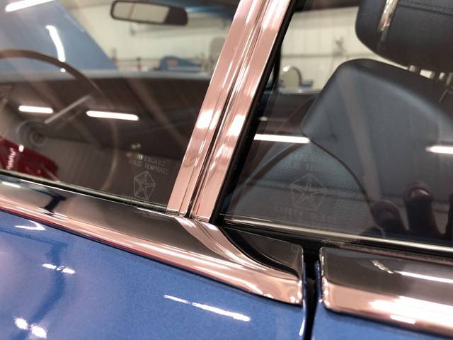

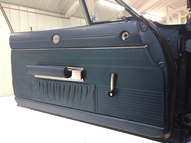

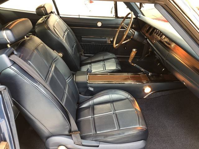

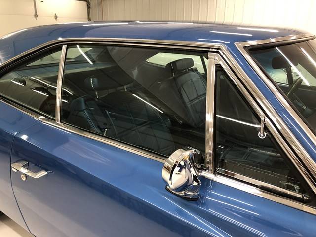

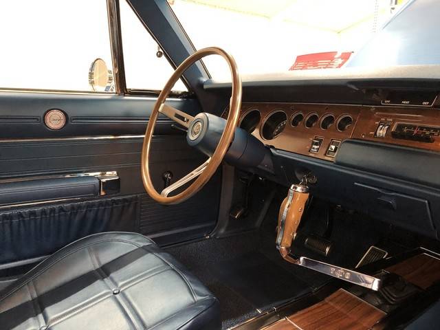

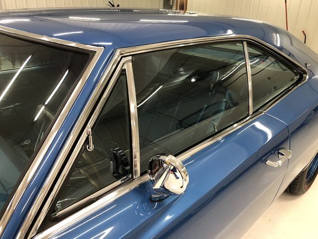

Did a ton of work on this, short list is-
All trim polished, AMD glass, new fuzzies, new weatherstrip, converted to 3 speed wiper in order to swap from single carb to dual 4's and chrome dome. Painted booster/master and radiator, finished brakes, new wheels/tires, installed complete interior, dynamat, bluetooth module for stereo. Had the wrong flywheel so swapped that out. Motor mounts put the engine to high so cut/welded those to correct. Had new parking brake cables made and got that working. Lots of wiring. Re-tensioned headliner. Had dash repainted, dyed everything else to match. Forgot the rest! Runs and drives great though and -everything- works :)
Thanks to everyone for help along the way. Especially Richard for all the parts and advice. :2thumbs:
