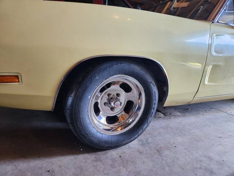

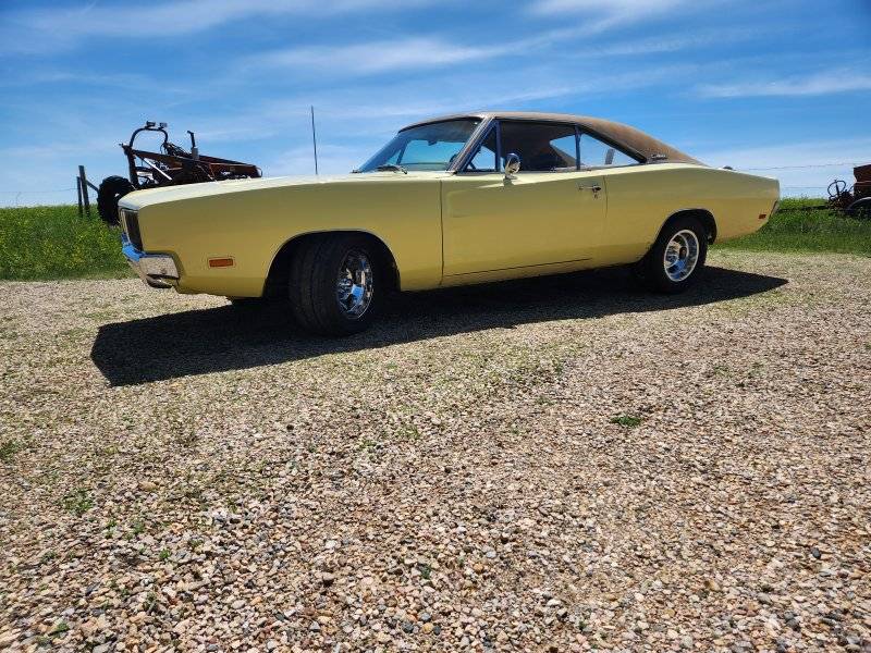

So got my new tires and wheels in. Mounted the fronts and really am excited they don't rub. 275/50-15 front tires.

Nitto nt555r2's. They're advertised as a drag radial but there's a lot of discussion on various forums that they actually handle quite well and they are very sticky. Keeping the muscle car look and feel is important to me. I could have gone with 17 or 18" wheels and made my life so much easier to find good cornering tires. But I want it to still be true to a classic muscle car. Ultimate performance is secondary to me. But I do enjoy tweaking and trialing on a budget. The wheels and tires are going to be the most expensive single change I make on the whole car.what brand/model tires?

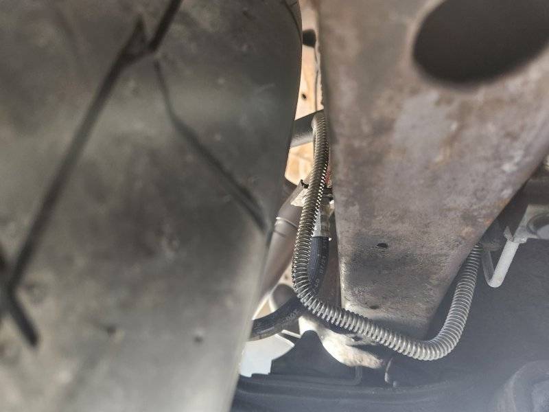

I took it for a quick drive yesterday and all indications are that it won't rub. We'll see under race conditions if that changes. But I'm about 95% sure it won't at all. It certainly didn't just in my short drive and I was trying to get them to bounce into the fender by hitting bumps while turning hard.Do the fronts rub at full lock using the 275 nittos?

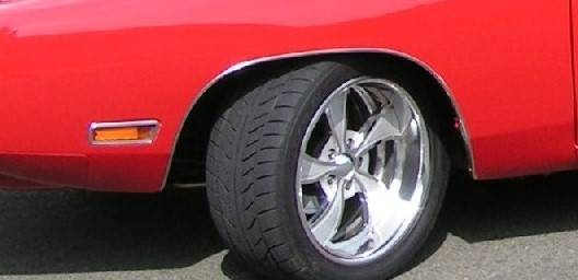

Your tires about an inch taller than mine and I believe you have a 4-3/4" backspace right? Your setup helped convince me the 275s would fit before I ordered mine. But my fronts are 15x8 with 4.5" backspace. So it's certainly tight!I have 275-40-18s on a 9 inch front wheel. Mine only rub at the frame rail behind the wheels.

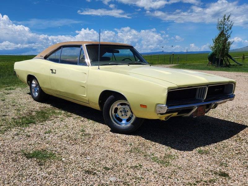

Old picture...but the new tires I have are the same size.

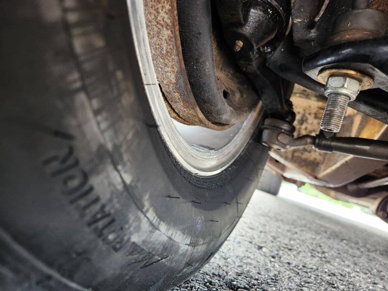

As far as rubbing. I think I'm going to order 1/8" spacers. Course was hard left turn heavy. My tires never touched the frame but appear to have just barely touched the tie rod end. Also because I must not have gotten my wheel studs fully seated the wheel actually contacted the upper a-arm. Tightening it back up fixed that. So I think a very small spacer is all I need.
